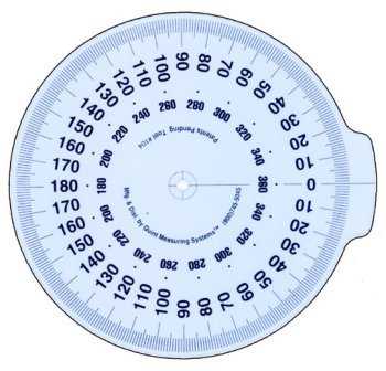

Hi, need some help.
I would like some moore revs in my P5 and learn from experience that if i open start of inlet timing on crank i get some moore revs on top. i did not get any change on bottom end.
If i open closingtime on crank will i loose any bottom end torque? I do not have a large numer of cranks to mod that is wy i am asking.
Thanks
Its the othr way around. If you want more RPMs, make the intake port close later. You will loose some torque, but not a lot.

Originally posted by am
Hi, need some help.
Thanks
Hi AM.
Sorry, I don't know what is P5 means, never had one in my hands. Closing of induction timing is one of the event which working in tandem with tuned pipe and it is realy helping on top RPM. But over cutting will defenetly kill torq, so if you stay within 65-67 degree you should be OK. On closing don't go bellow 35-everything bellow 35-makes engine realy reach on bottom end and it will some sort of hel to tune for punch out f corner.
If you find somewhere thread named engine modding ( or so) in this zone ( nitro zone), I put there very good link to one German airmodeling side with good testing ### and it will help you understand how it works versus crancase pressure.
Edward

Hi Edward, THANKS.
A P5 is an offroad Novarossi engine. Sorry not to explain that.
I will try to find tha link to germen air modelling web site.
How do you messure degrees. I now i can make a 360 deg cirkel and monunt on crank but i find it to be not very accurate.
Hi Edward, THANKS.
How is going?
If it is off-road engine I will not recomend to make 35-65 timing on induction. To be honest- I have never deal with off-road engines, but I do belive that 37-60 should be good numbers for it.
I use contractor's protractor I bought in "Home depot" here in USA. It is made by "Quint measuring systems" Please see attached pic.
I am attaching it to cranckshaft. Engine has to be firmely attached to some sort of frame. Then you put piece of wire to that frame and set cranckshaft position to bottome dead center and wire pointing on "0" on protractor. Then you will measure when induction port open on cranck and when it closes. the same way with transfer and exhaust.
Edward
