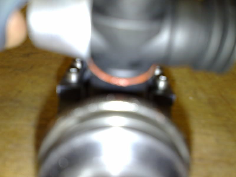

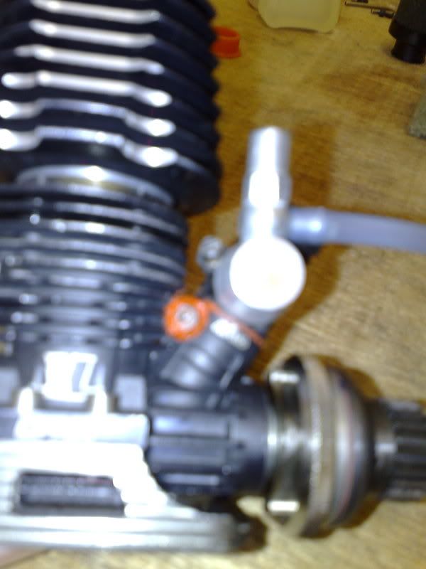

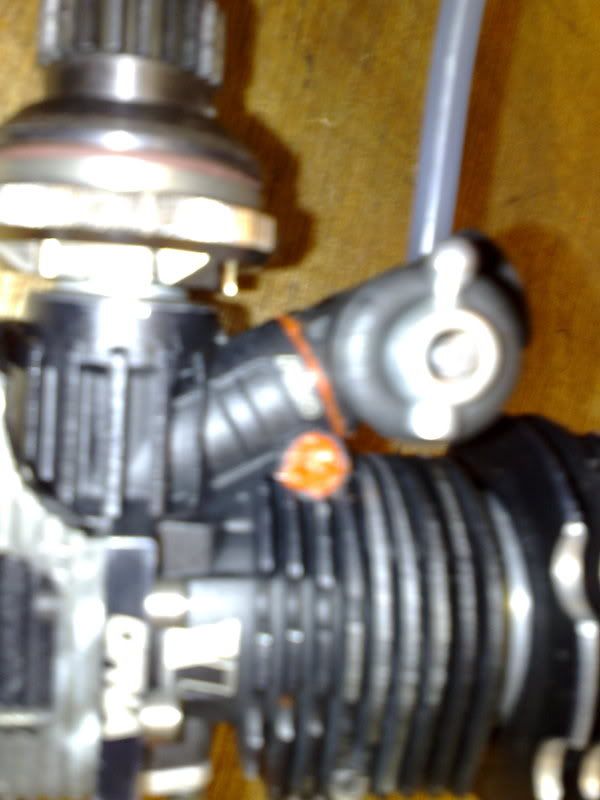

Originally Posted by jeff1
I put Three bond red silicone RTV on carb neck and o-ring, then push it all the way down and tighten screw pinch bolt I also put some sealant around screw and other side too, removed excess with tip of slot tool and paper towel, did I do right?
There are more parts to seal?
Maximo, can you post pics of your engine sealed?
guys
I want your opnion regarding seal the carb. First, its really necessary? How to know if it needs to be sealed? Where to seal?
If you want to seal your engine for precaution, then put some sealant by the carburetor neck before installing it into the engine, do not use too much, all you need is a little bit, and wipe off excess, just make sure you do not let any of the silicone sealant material get inside the engine.
ps. The carburetor neck is the only place you want to put silicone.

Old 04-10-2008 | 07:54 PM
  #1354
jeff1's Avatar
Joined: Oct 2004
Posts: 378
I took pics see attached sorry for quality

Jeff,
You did good.

Posts: 445
Jeff1.......be careful when you go to remove the carb. Remove as much of the sealant from the base of the carb, and completely remove the pinch bolt assembly and sealant. You've pretty much made an air tight seal which is fine. When you run the motor for an extended period, the RTV will get hard. The carb barrel(the part that goes into the engine) is composite with an aluminum sleeve bonded to it. If you twist and pull off the carb you may leave the aluminum sleeve inside the engine.
