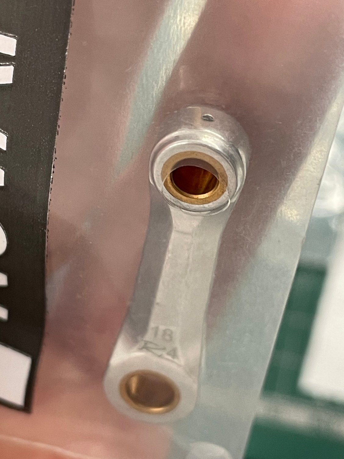

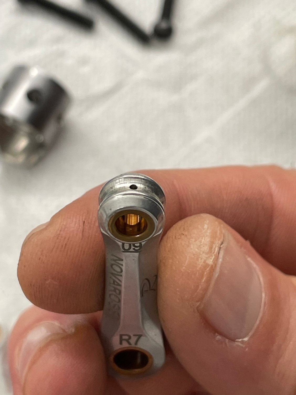

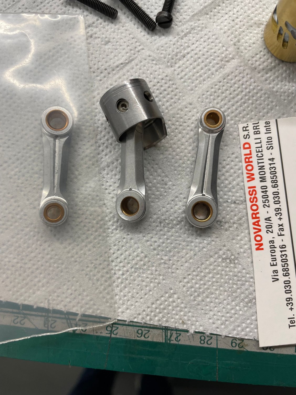

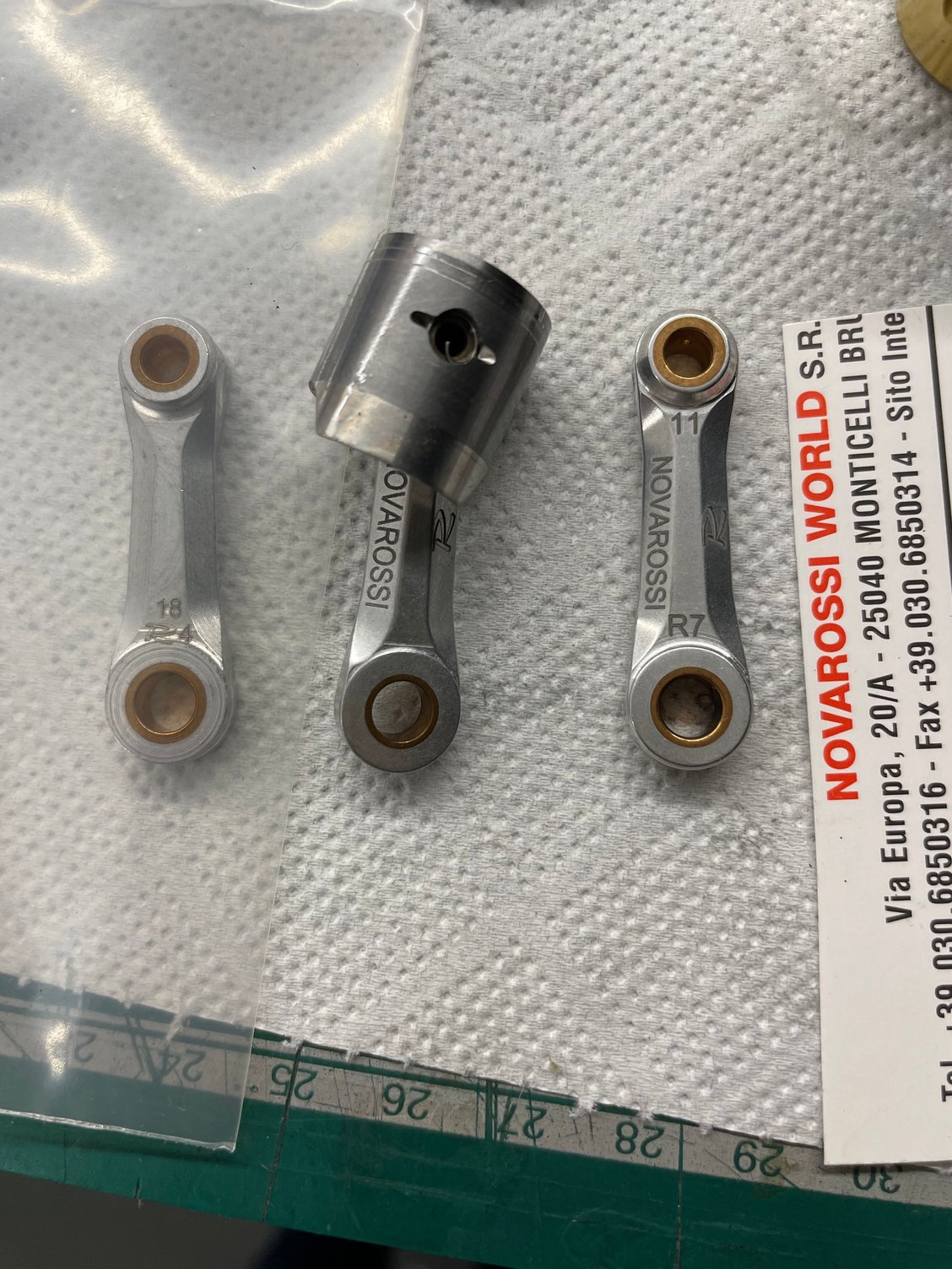

Hello Everyone.
I bought a Novarossi Mito 35 WC some time ago and was prepping it for break-in, so I disassembled it to verify everything was OK.
However, it came with a connecting rod that has no model number, and no top bushing. I've never seen one like this in all my Novarossi engines.
I read somewhere that some of this engines (sold after Novarossi closed) were assembled with old stock parts bought from the factory when it closed.
The question is: Is it safe to use to use this rod as is, or should I replace it with a proper R4 or R7?
In the pictures, the said conrod, along with a R4 and a R7 for comparison.
Mito Rod
Mito Rod Top
R4 top
R7 top
R4, mito, R7 front
R4, mito, R7 back
Mito Rod
Mito Rod Top
R4 top
R7 top
R4, mito, R7 front
R4, mito, R7 back
The rod w/o a top bushing is to my knowledge only used by JP engines and got R6 as model number. It needed to be used with a DLC coated piston pin but from own experience it works fine on a plain steel pin as well. If your pin is black coated then it is assembled as it was mentioned.
Unfortunately, no DLC piston Wrist pin. Just a plain shiny silver steel one.
From your experience, is this conrod less durable than a standard 2-bushing one, or will it provoke more wear to the piston wrist pin?
