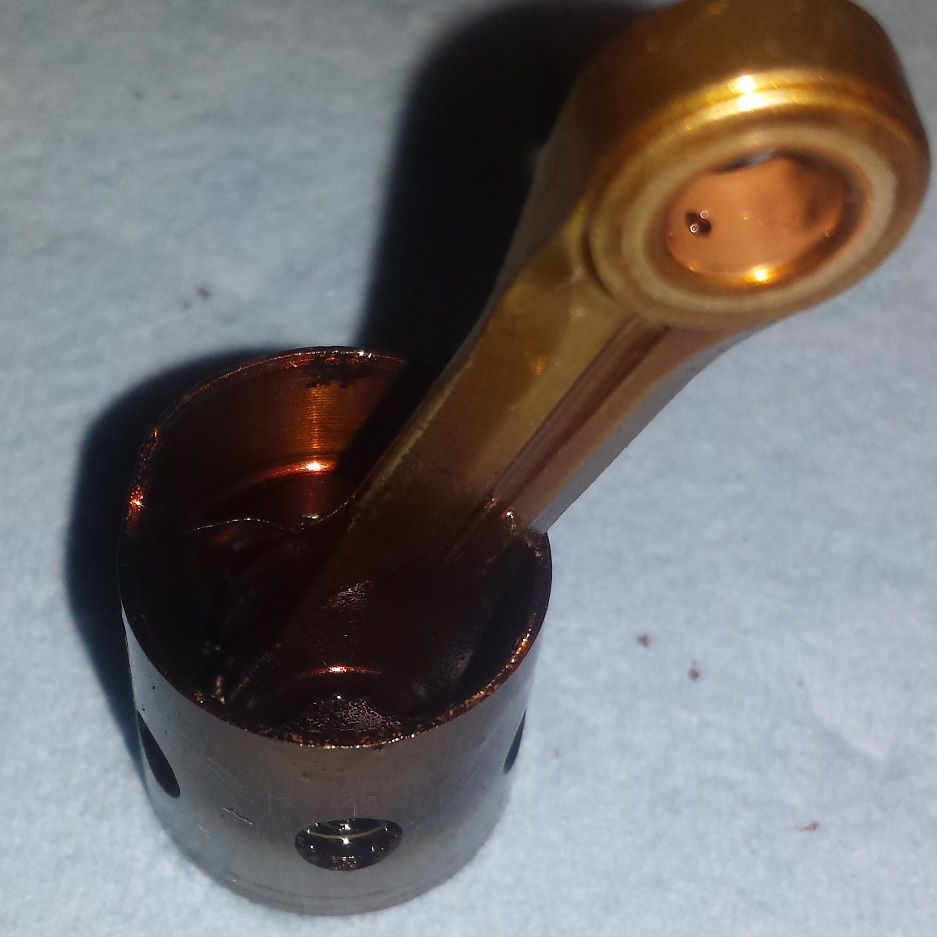

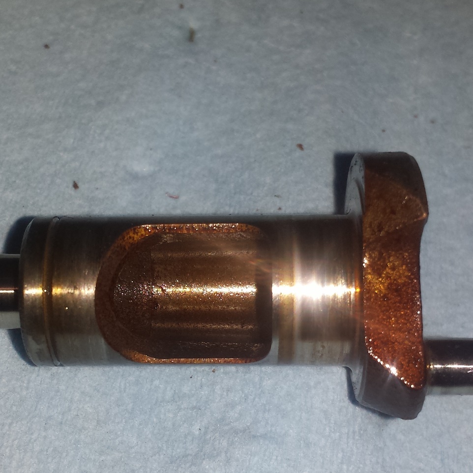

bretto107 01-11-2017 03:30 AM
sorry for the multiple post,i'm just learning how to upload photo's.
I pulled down 1 of my motors and the photo's above are what it looked like.There seems to be dirt getting in under the button. Any idea on how this could happen. All the screws were tight. Also what is the best way to clean the motor. I would like to get it pinched.
cczjordan 01-11-2017 04:58 PM
It is normal to have a bit of dirts at that area, use denatured alcohol and tooth brush with paper towel, if u send for repinch then just let the expert do it for you. Anyway wat fuel do you use?

bretto107 01-11-2017 08:32 PM
In the photo of the crank, is that dirt stuck to it?
dan_vector 01-11-2017 08:56 PM
Originally Posted by bretto107 (Post 14797396)
Hi. Im having trouble getting the button off the motor. Is it normal on Nova's or am i doing something wrong. It is really tight into the sleeve. I have to use a screw driver to pri it a bit.
Also i have a new motor that i pulled down before i used it and when i put it back together i put the dot on the button forward. Will this be a problem? I have used the motor since doing this
The dot on the button should face the exhaust port. This is what the dot means. As someone else mentioned take the plug out before trying to remove the button and yes they can be tight in the sleeve. It's important that you remove the button straight.
The gunk you see in the photos isn't normal or good. That is corrosion as a result of using poor quality fuel or an old fuel that has water in it. Nitro is hydroscopic which means over time the water content of the fuel increases especially if it is not stored correctly. It also builds up if the engine hasn't been stored correctly.
You need to remove the gunk before running the engine again. You also need to ensure that you are using a good/clean air filter element. I can also see evidence of erosion from dust etc that's been going through your engine.
