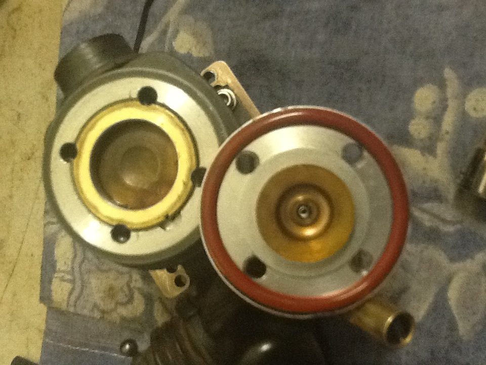

shimano 10-15-2012 05:07 AM
1 Attachment(s)
shimano 10-15-2012 05:08 AM
1 Attachment(s)
