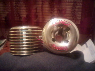

New cooling head we will be marketing.this will fit GOTECH EBM5.Also looking for other engines people would like to see a head for.all CNC machined.we have a total of 30 years cnc expirience and are open to other products also.
look for this head to starting this weekend at local tracks in pa.
give us your feed back.
also to engine modders we are open to working with you on your own head design ,engraving,and anodising for your own distintive look.
Attachment 447974

Donut you close to me, I want 1 of those. That looks sweet how tall is it compared to the newer GO heads.

looks cool,hope u dont mind me attch to my post should be easier to view...
can u lightn its weight up by machining holes in the cooling head ...and how much does this 1 in the pic weigh?
looks like a well designed head.....im sure malik will test it out soon:sneaky:?..lol
