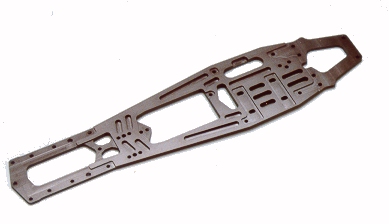

Cartman 02-08-2003 05:50 AM
Originally posted by modellor
It will be lighter helping with acceleration around our nice tight tracks in the UK but if it lowers the CG because its milled out I am going now to get my dremel out. lol
Making the chassis lighter and reducing its total amout of metal will actually raise the CG in effect. Because you are making the heavier part at the bottom lighter.:nod:
ok how i see it the chassis stock is 3mm, new one 4mm with BITs machined out, cant see it can be much lighter
c of g i agree with your bit

I asked Robbie Collins about the weight (on Starting Grid). He said he'd find out next week. Personally, I hope it's heavier than stock. My car is barely race legal in it's stock form. I'm in the process of lightening drive train components, so I fear I'll be seriously underweight. Hopefully the new chassis is heavier to give me back some of the weight with the added benefits of it not being on rotating mass and it being low to help the CG.
