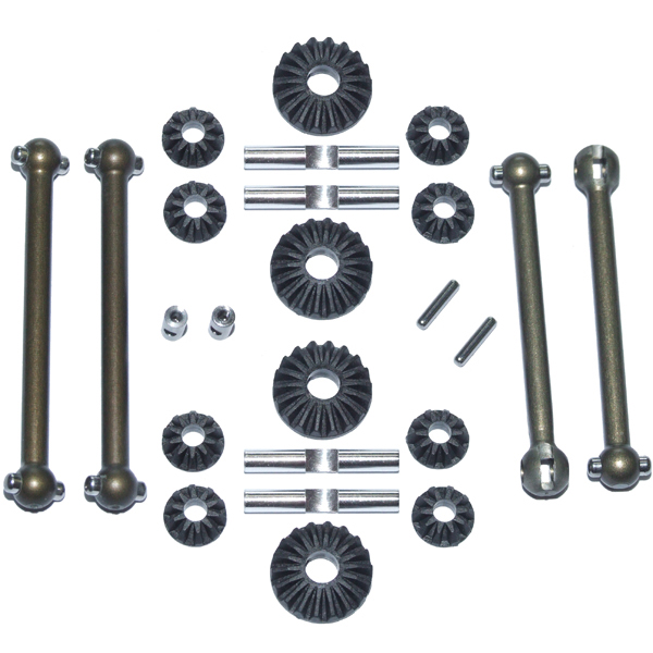

This has DS_Motorsport written all over it... :lol::lol::lol:
http://www.capricornrc.com/os_capric..._NT1_Light.jpg
Ultralight transmission kit for NT1
Include:
Rear ultralight dogbones
Front ultralight universal swing shaft
2x Ultralight differential gears
2x ultralight bevel shaft
Xray Transmission Weight: 61.2gr
Capricorn Transmission Weight: 18.4gr
http://www.capricornrc.com/os_capric...oducts_id=1179

DS Motorsport 02-17-2010 06:52 AM
Haha, that's funny.:lol:
I already saw them in my inbox.
But I already have the diff internals, only need some new outdrives so I can build a set of lightweight diff's
The driveshafts I don't want them anymore. They are made out of aluminum and I had them in the car last year.
During the final race of our clubracing season one of the driveshafts snapped off completely while I was leading the race. There weren't any signs of fatigue what so ever. So I think they are too unreliable, unless you change them after 2-3 races maybe. But that would be ridiculous.
musti72 02-17-2010 07:53 AM
I dont think Capricorn would put a part which is that much fragile on their kit, assuming that they are the same material. It might be a failure because of another reason on your shafts.
