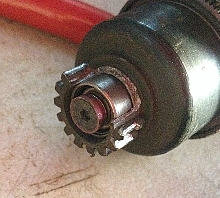

It broke on the straight, just one gallon.

Bummer. Is that the stock bell? If so, you can email Tekno and they will help you out but this is the first I have seen of a stock Tekno bell breaking, I have broke other bells just like yours broke but not tekno.
