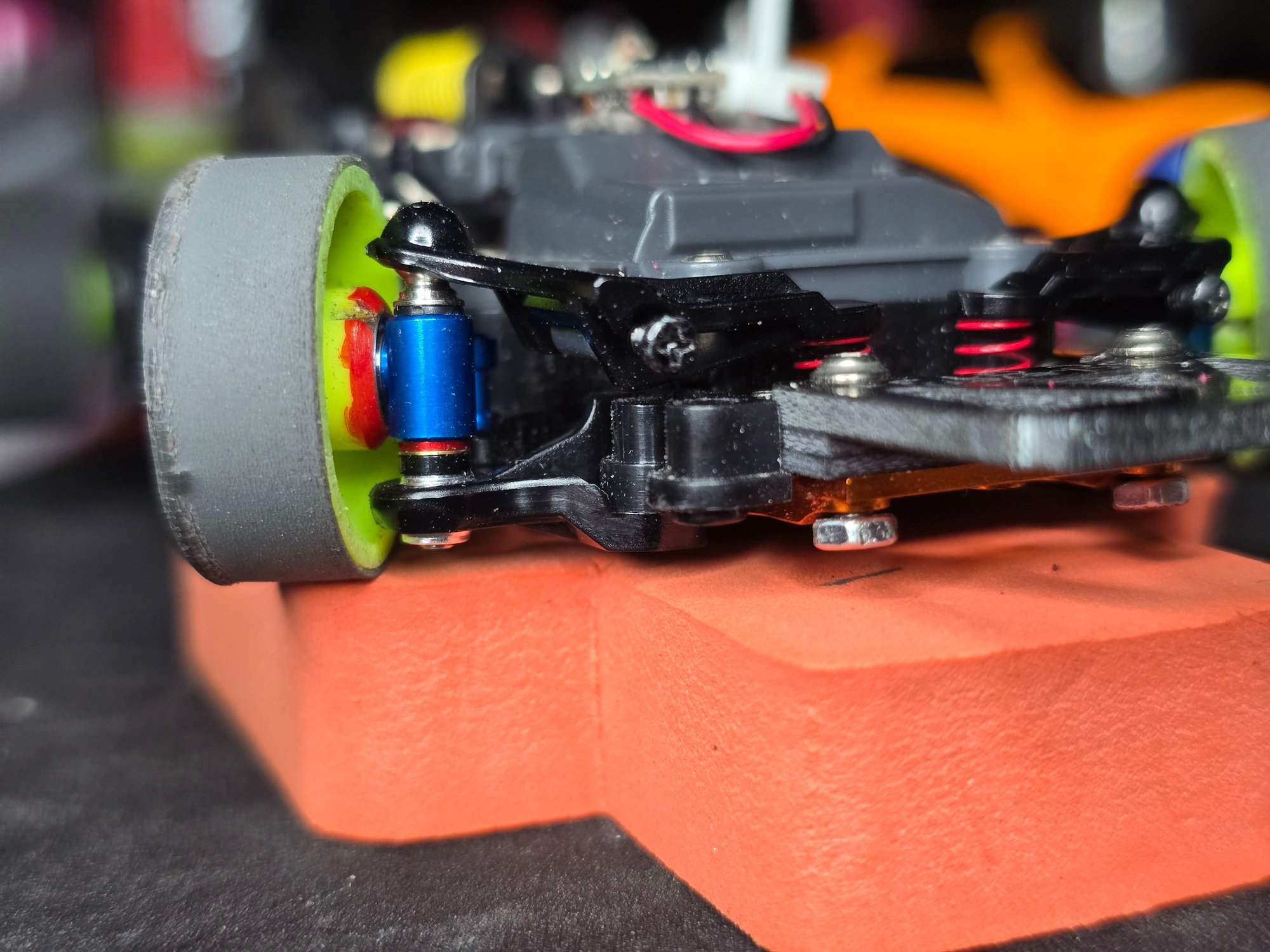

I got the V2 MR04 arms in today, and I put a set on my MX-5 chassis, because of the +1mm front disk wheels would catch on the walls with anything more than a slight brush with the walls. I measured the front track width before and after , 69.45mm to 69.00mm outside disk to outside disk. I then ran it with the same wheel/tires, and while the new arms look the same there is some slight changes, because the disks would rub the body after the change during a 75%+ turn. So I went to 0mm 20mm Disk wheels, and adjusted the shim stack a bit, and 0mm wheels ran perfect, and tuck the wheels under the body enough that brushes with the wall no longer stop the car! With a bit of adjusting of the steering d/r and -expo, I was flying again!!
The redesigned arms, are beveled on the outside edges of both the upper and lower arms, and are slightly thinner in build. Overall a upgrade worth the $6 or so dollars! The king pins and lower balls do have more free play compared to the V1, but as of my limited testing I couldn't tell a difference. The upper arms have been beefed up some too, and feel much stiffer.
V1 MR04 Arms
V2 MR04 Arms
V1 MR04 Arms
V2 MR04 Arms
On my Readyset MR04 the V2 arms allowed me to remove the .5mm shim I had behind the wheel for clearance, which between in new arms and the narrower track had it turning better than before, which took a little getting used to. But I turned my steering d/r down 2 clicks (4 actual numbers lower) and had at it! I was a few seconds slower the second run, but I was able to hit a 4.3xx second lap vs. a 4.4xx with the V1. So with a little practice with the V2 version I will probably be a better!
You can see the beveling of the arms in the pics to clearance. Again I feel they are worth the $6+ bucks and the time to put them in.

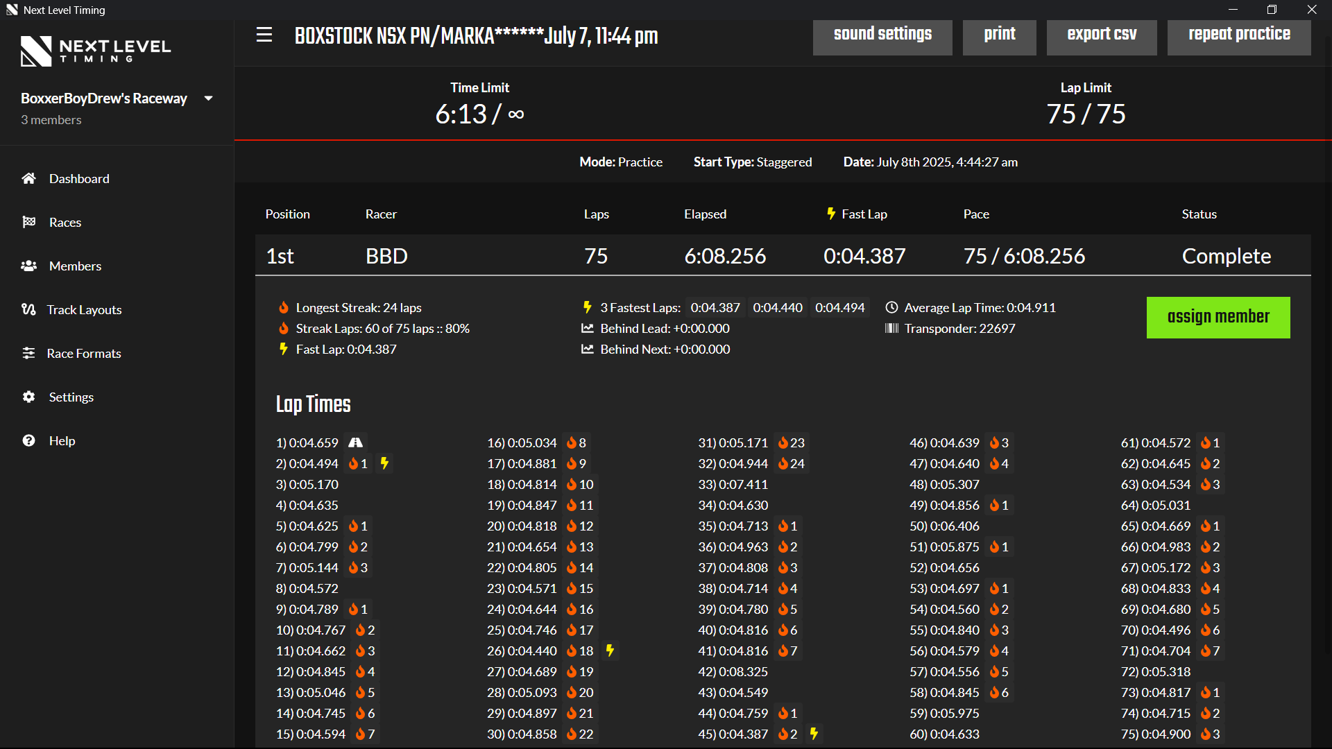

I ran my BoxStock tonight with a NSX Body and tested PN KS-M Medium Low Height on PN +1mm 20mm Yellow BBS fronts and Marka V1R10 slicks on Kyo +1.5mm 20mm White Camaro wheels against Kyo 30* LH fronts and Kyo 20* Radials on the factory NSX wheels. All tries were taped with PN tire tape, and while I did super glue the side walls on the PN tires a long time ago the Kyo tires were left alone. No other changes were made to the chassis or radio between the tire change. I was used to the PN tires, so handling was pretty good. The Kyo tires took a bit to get used to, as my breaking and turning points were different, but it was ok on them. Better than I remembered from a few years ago. The fast lap times weren't that far off, but that's deceiving, as I wasn't pushing very hard on the PN/Marka tires, but it was all I could do to squeeze out that lap time on the Kyo times. Really a perfect lap, for me anyway, with me hitting the brakes just right into the fast 180*s and rolling through the others. On the PN/Marka tires ya still had to be mindful of TR, on the Kyo tires the car wouldn't TR all the way, but would want to veer into the wall instead of flipping over.
Anyway here's the times
The TR probably wouldn't be as bad if I would have mounted the body 1mm lower. The humidity is bad here at 71% at 71*, so traction would usually be different at the normal mid 50% range it usually is this time of year too. Anyway here's a side by side comparison of the tires. Next test will be with the McLaren F1LM.
