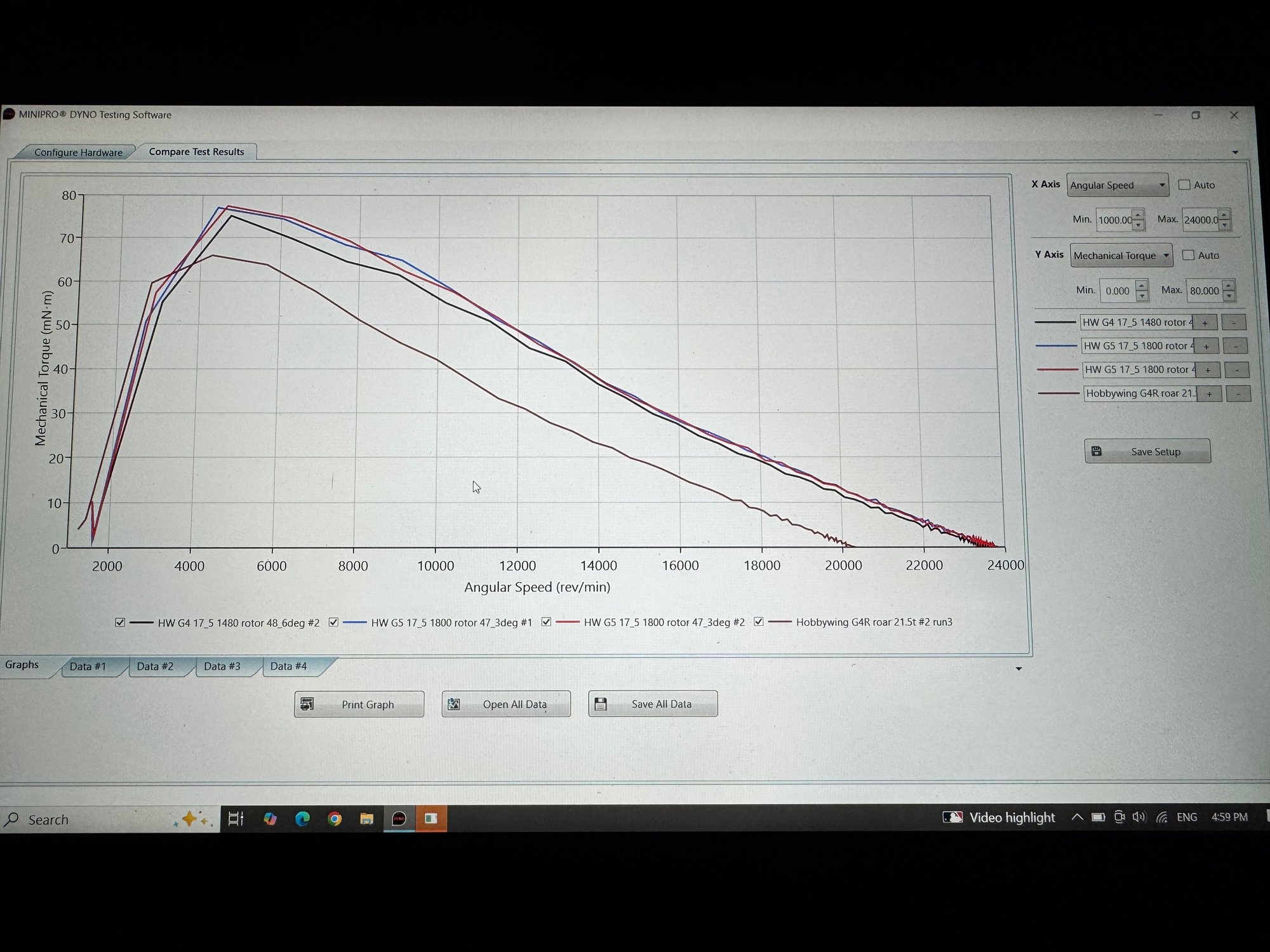

Comparing the torque output between a HW G5 torque and a G4 with an option rotor from G4R (1780G), so the G4 would be more like a G4R in reality. You will see the timing information in the description of the graphs. The G5 draws more current even though it is at a slightly lower timing however the stator resistance of the G5 is lower so it will by nature draw a little more current.
There is virtually no difference in the efficiency throughout the rev range. There is a good bit of gain at the mid range while it retains the same top end, so it is a win for the G5.
I was able to get the timing deviation to be pretty close by using the 3 adjustment screws.
I have included a HW G4R 21.5t for reference.

I will have to work on the display of my test data, but on a Fantom I saw almost no difference between a G4R with the torque rotor or G5 with its torque rotor. The G4R was a epoxy version so on the way out. I did not check the strength of the rotors. On track they ran almost identical lap times too.
