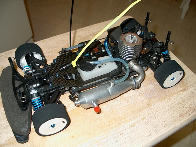

Yet another needle setting for the O.S. .12 TR (P)-T R-Spec.
High side needle 1 1/4 out from closed.
Low side needle 2 3/4 out from closed.
(Middle is per instructions 1 1/2 in from flush with the carb body).
All these settings are after break in. I also can get over nine min of race time at about 218 deg. But I intend to try the other settings listed. Just to see what difference they make.

9 minutes haaa...i must try that...very great advantage in long mains...cuts refueling time as long as no overheating occurs

Yea, I kept thinking something must be wrong with my engine, until another racer who runs the exact same engine said he got 9:45 min run time. But I really haven't tuned it to race and just now will run my Logics turbo II pipe and this is the stock gearing not the .08... I'm sure it won't last.

i'm on the verge of getting me the rd logics turbo II, so how do u find this combo with the ostr??
