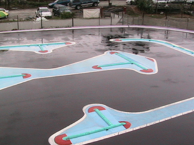

Mie3R 09-20-2005 06:17 AM
Originally Posted by suntok2
Do you have website for the result? I like to see some picture.:)
this is the result :
http://www.jlapracemanager.com/cgi-b...asp?where=niko
Sorry there's no picture taken to show u but somebody makea vcd on that racehttp://www.rctech.net/forum/attachment.php?attachmentid=69877.http://www.rctech.net/forum/attachme...chmentid=69876
