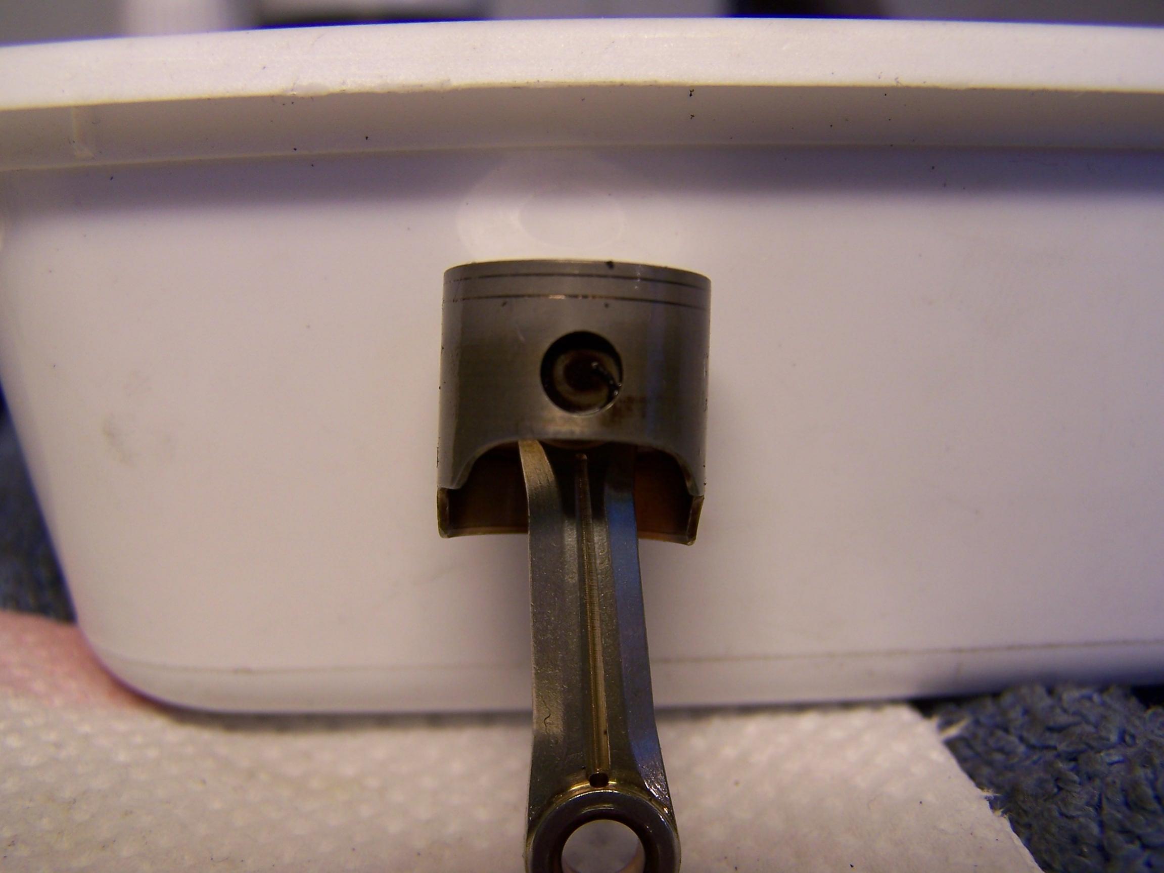

If you want some extra performance try something like this, no need for a degree wheel. You will only need a steady hand, if you have an old piston laying around you might want to try it on that first.
I don't do anything with fancy polishing or fancy grooves.
Btw this is al i'm giving you, the rest i will keep to myself.
Attached Thumbnails godzukihop: your hyper 12 is ready-100_2691.jpg
