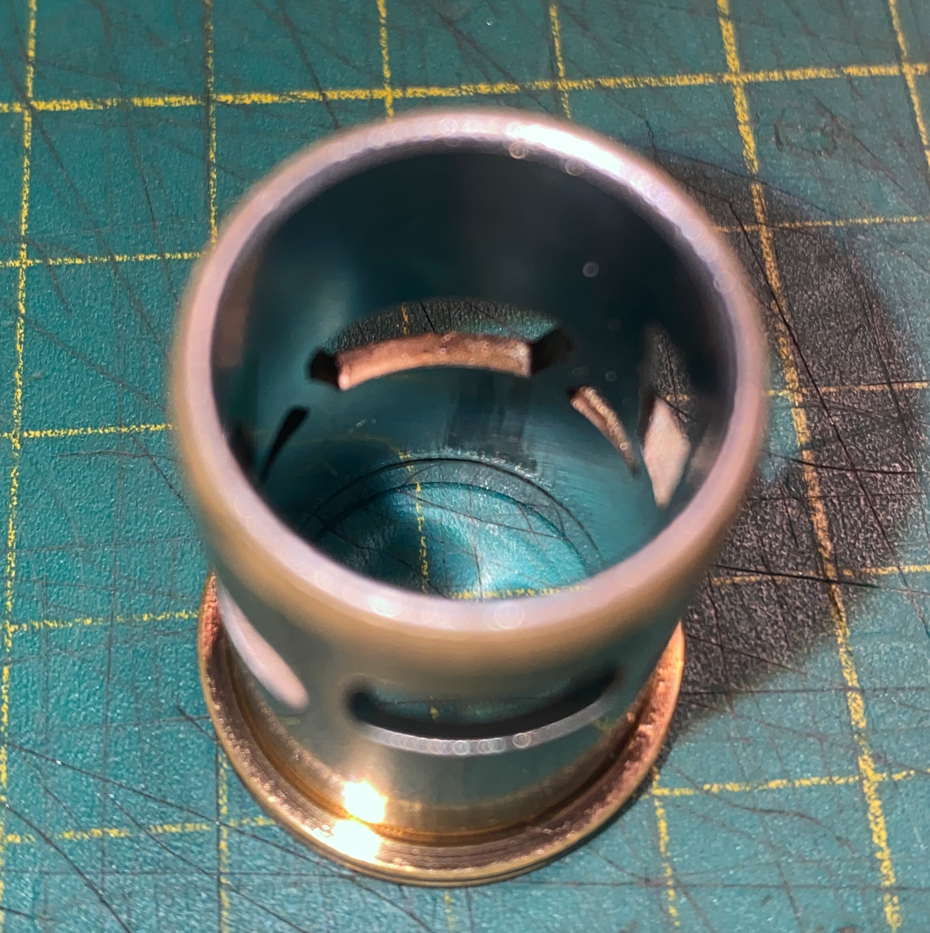

Originally Posted by Slo-MTX4
Its interesting. I have experienced marking of the piston during run in even with more oil but I know I was just pushing too hard. It wasn't in the sealing area so I cleaned it up and it runs ok, but then it started picking up in another spot. So you could be right. Do you use energy/maxima? Assuming you add extra castor?
Curious as to what this marking on the piston looks like.
R/C Tech Forums - View Single Post - OS R2104 engine Thread

Posts: 4,400
I was curious because I had the same thing happen to one of my Ultimate M5S engines (PS set is OS B2103 type R) last year while doing the final break-in though mine's not as extreme as the one's in the link. I was using Bones break-in fuel added 50/50 with 30/8 Bones fuel for the initial break-in so I know I was getting plenty of oil for the process. I tried measuring the piston to see if the spot was worn more than the un- affected parts of the piston but it was the same side all the way around. Also there is marking on the sleeve, both on the exhaust side. I noticed it after a tear down for inspection at the end of the day. I replaces it w/ a new P/S set and haven't had an issue like this with the new set. I've never even had this issue before w/ any of my engines. Are these just over polished spots from carbon buildup or something different? I haven't used the set but am wondering if these marks will impact performance.
petersen114 is offline
Old 11-29-2024 | 06:52 AM
  #29
Roelof's Avatar
Tech Lord
Joined: Aug 2007
Posts: 14,044
From: Holland
Hard to say what is happening but on the 1st pic a small black spot on the left side should be related to a specific spot on the sleeve. As mentioned by me in that R2104 topic, in the past it was normal to remove all sharp edges of the ports and I think that still will help today. About the spot over the whole side, a friend who worked at a metal company said such spots look like a cold welding. A moment that the pinch and temperature was high and the lubrication too low. Still I do not rule out that the rough edges of the ports can be the cause.
