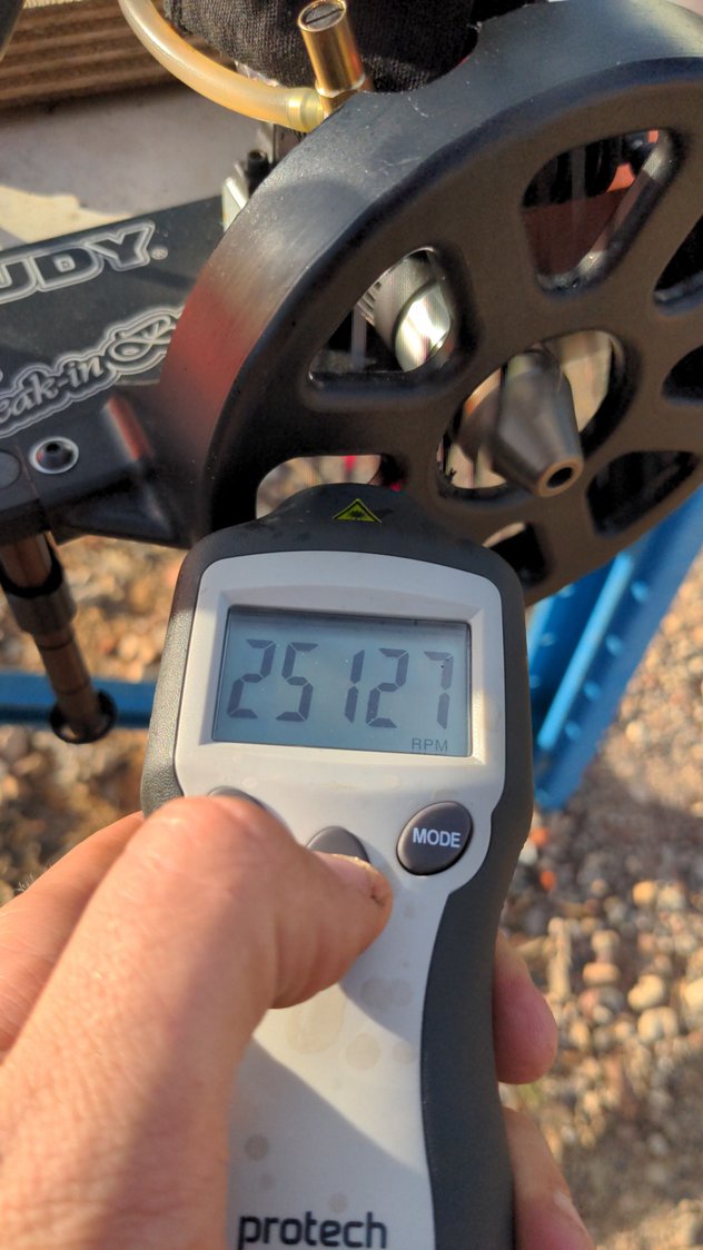

1500ml through one of my 2104s today, first time I've done this set up so learning a lot trying to keep in the 80-85°c range.
Seems to be okay, I added +3% castor so total of 13% but internal looks brand new nothing like a Hasi or Ealasi.

Default 1560ml Prop Break in
Here are some pics from my 2104 #2 this has done 1560ml on the Hudy Break in bench, kept at 80`c.
running +3% oil in this fuel also.
Having seen some internals of "pre run in" engines using energy fuel with large castor build up this wasn't what I was expecting.
