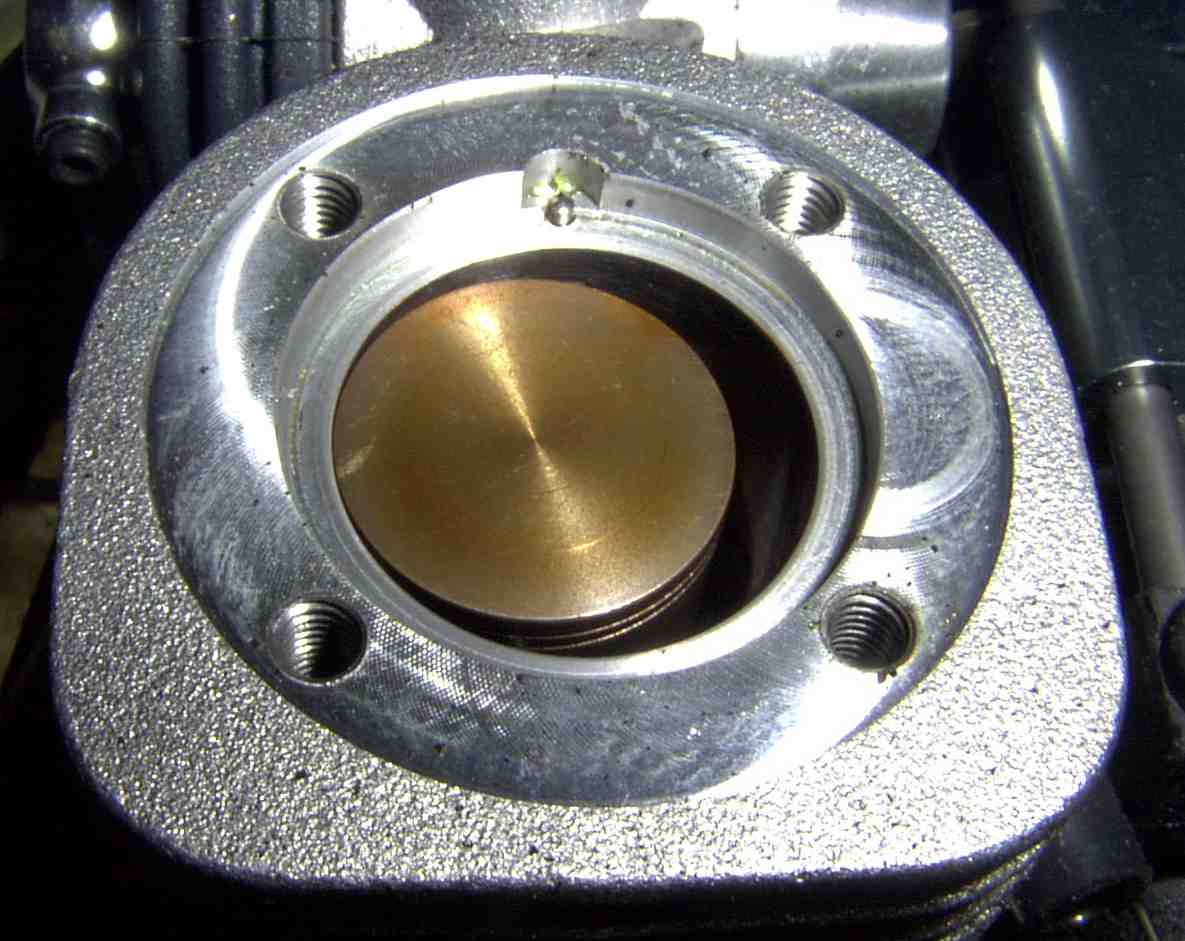

. Temps are starting to come down now that the engine is starting to loosen up. Got about 1/2 gallon ran through it today, temps around 230 and 260 when tank is at lean empty. Mtx4 is now complete with all upgrades. We got a temp today at 310, but that is strange, blowing smoke and the plug is shiny.....I think that the head is so open that you get so close to the plug that the temp thing is going to have to be tossed out the window on this engine, or I will just have to come up with a larger silicon head for the exergen.
Pulled the engine down to inspect, looks like new inside, nothing discolored, carbon build up, nothing....looks like I just took it out of the box. Running 30% now with the extra head shim.
