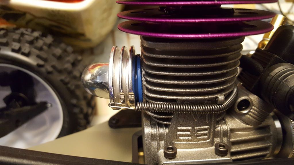

Can anyone tell me if the gap between the header and exhaust gasket is too much? The exhaust hanger that came with my kit is a little on the short side for this pipe/header combo. Just wondering if this is enough to cause a leak.

Hello Cardiak,
I suggest You to find a longer Exhaust hanger. If You run Your Car with the manifold position like in the picture, I would say that the gasket will ruin prematurely and it will cause leaking.
Cheers..
Originally Posted by Cardiak
Can anyone tell me if the gap between the header and is too much? The exhaust hanger that came with my kit is a little on the short side for this pipe/header combo. Just wondering if this is enough to cause a leak.

That spring on that postion does moet give a strong tight connection. Pop the spring over the small engine side hole so it will fall in a groove of the wider engine cooling fins. And with Novarossi springs it is wise to use a 2nd spring...
Probably then the gap at the manifold is gone.
Because you did install all new, there is a chance the silicone rubber is not seated well creating the gap. With new rubbers it is wise to use some oil to mount the manifold.

I use 2 springs on my Nova 28-8 (41017 manifold and 9886ss pipe) and I custom bend my hangers as to not put any stress on the exhaust or cause any movement once tightened down. I always install the exhaust, use 2 springs, and find the point where the exhaust is square and tight. Then mess with the hanger to keep it right there.
Cardiak’s kit came with a hanger that needs to be tweaked a little bit to fit just right. I don’t think he will need to make a new hanger.

Here’s my 28-8RT with the dual springs on the manifold.
It looks like you need a longer hanger for the pipe, piano wire, wire coat hanger work fine and (depending on diameter) bend easy
