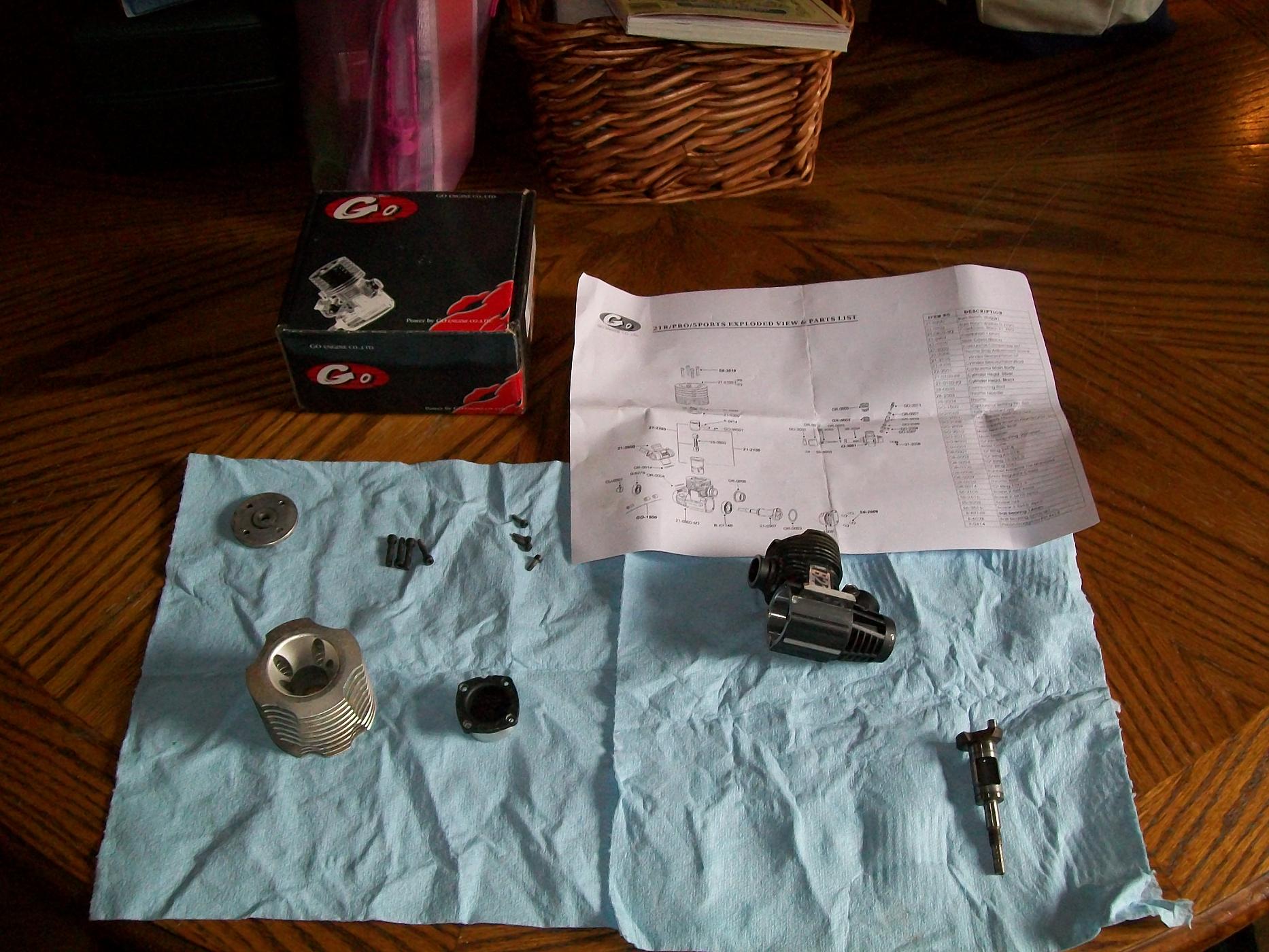

Sorry folks. I didn't realize I would have such a huge response. Here are some pictures.
This is a B21 5port. You will need a piston, a sleeve, and a carb. The block has a chipped fin near the rear head screw hole. The engine still will seal. You can see it in the picture below.
To buy $100 + shipping
For those wanting to trade, I'm looking for hitec servos HS-985MG. I think 2 servos would be a good trade.
