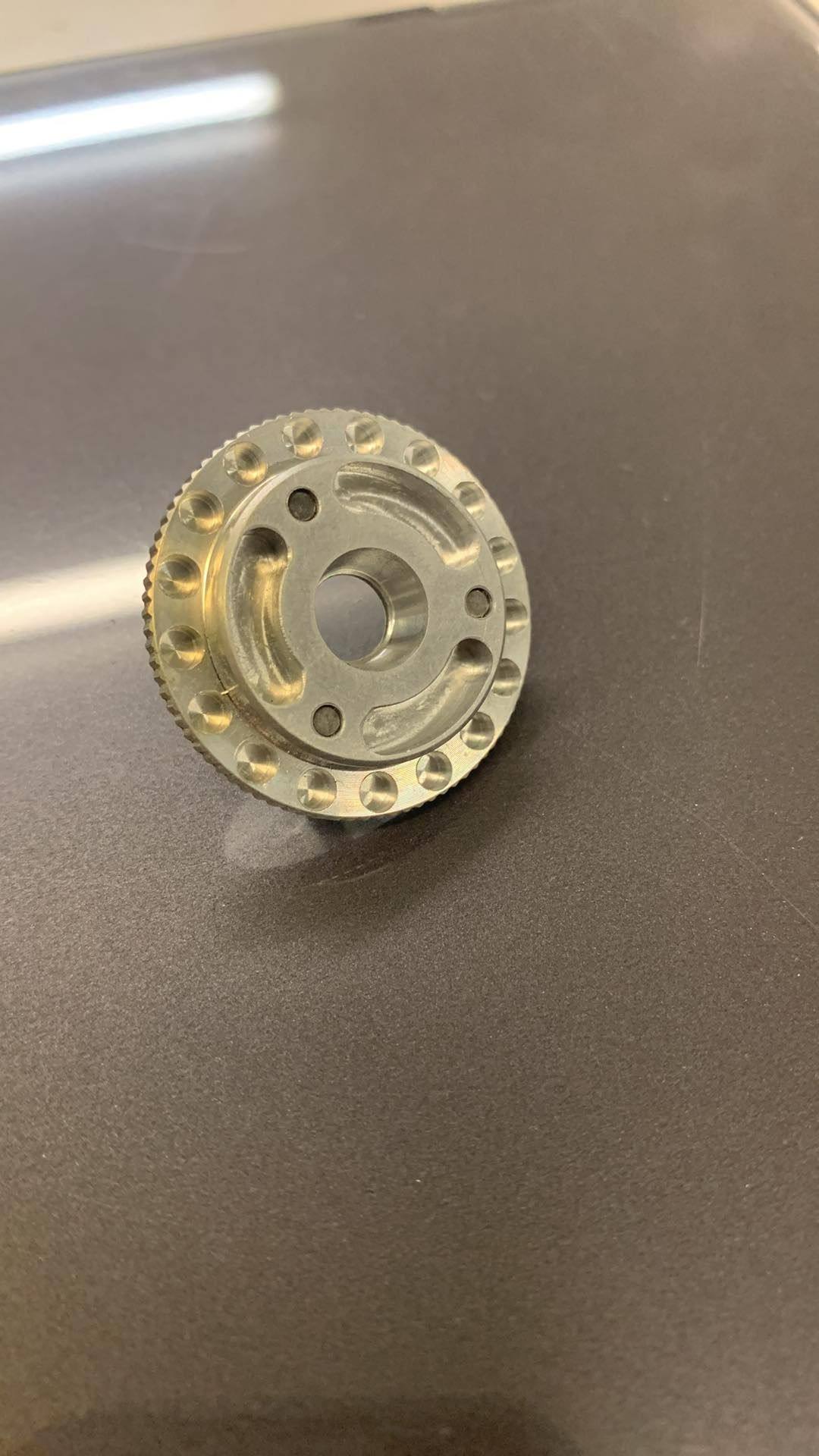

In addition to the clutchbell you could run the new dynotech lightweight three shoe flywheel. It should be about a few grams less than the original three shoe non pullstart flywheel...That should have reduced the whole clutch assembly by 12
grams or so with the aluminum bell...

Dynotech racing makes an even lighter two shoe version that is only 4grams, and will also reduce the whole weight of the assembly by seven grams or so for a total clutch weight around 23grams...

The OP had great success once he geared his tc3 with the dynotech racing 19t/25t with 54/48 spurs...Associated only had their cars way overgeared for .12 motors and racing on a standard track...Aim at 7.1fdr/4.8fdr and you will be competitive....Centax style clutches are around 40grams compared to 23g-29g for two shoe/three shoe clutches with aluminum endbells...
