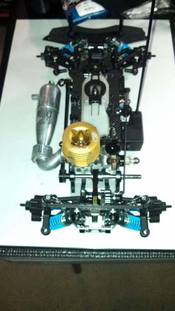

From: Texas
So I have completely stripped down the car I bought and am rebuilding it. I took the advice of purchasing a one peice motor mount and am running into the issue of the one peice is wider than the standard mount and cannot get the motor to line up straight with the gears.
Am I missing something? Do I need to dremel out the mounting holes more?

K so...I figured it out the spur gears that came on the car were 58T for the 1st gear and 53T for the 2nd gear. According to the "middle" gears they are suppose to be 53T for 1st and 48T for second. So as it seems the spur gears that were put on this used car were much too large. LUCKILY I purchased extra of the middle gears from the manual. Problem is the 2 speed pieces now do not fit the gears properly. ....This is exactly why I don't buy used stuff lol...
So with that being said can anyone tell based upon the below picture what kind of 2 speed this is?
Totally amped to get this on the track when it's complete. ALMOST there lol

the two speed looks like 4r but take it apart and if it has a little ball bearing it is wrong mtx5 should have a roller bearing that goes right across in side have a look at pinion sizes they could be wrong to make it fit if you have the book you will se what I mean you will have to get hole new 2 speed //aluminium bits exc we have used wrong to speed shoes
they will work but not as well as the right ones that's the black bit
greg
greg
The pinion sizes are 15 / 20. I didn't pay attention to how the guy who had it before me made it work because I always completely rebuild the car to my liking when I get something used. With the combo he had I could get it to work if I made the engine angled but knew that was definitely not right. If this is a 4r 2 speed does that mean I will need to replace the inner 2 speed shoes?

15/20 is right and nitto is correct very carful sit up is needed or you will strip gears neally all 5 have some sort of brace we did from tray to beside diff used 1/8 stering arm but now we have ///trackside rc brace and have knot striped a gear for years of big events you shoud get complete set all the bits in the photo///if the bearing is a needel and not a ball to speed may be correct but the other bits are wrong to look at
greg
Hey Jay that is not the right second gear housing...the one that come with the 5 has a big hole in the middle with no bearing, the bearing goes in the spur gear itself, the first gear housing is wrong too but it should work, the newer one looks less bulky then that one in the picture.
