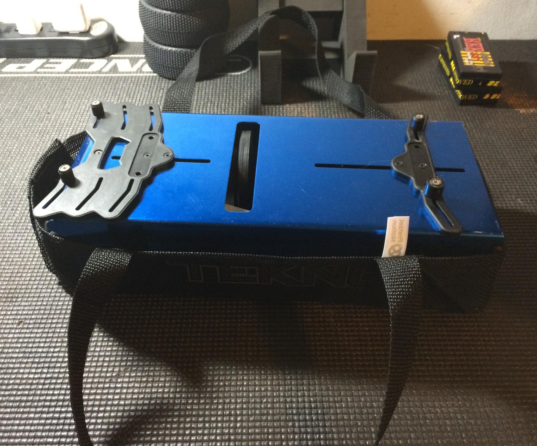

Having some trouble getting my blue ofna box to work. Its been used before so the wheel is worn down to 74mm instead of what it is new (76mm). But I don't think that's the problem because the wheel is being stopped by the chassis and I would think a smaller wheel would fit up in the slot further and make contact with the flywheel easier? I definitely don't wont to grind out the slot/chassis to get it in there, but the flywheel seems really raised. What other starter boxes are guys having luck with?
I had to do what mr240 explained. Switched the brackets and drilled a new hole to close the top. You'll notice the pegs shifted to the left as well. I've also added rubber tubing to the front right peg to tighten the fit up.

Thanks. Got it lined up and turning over now. But my rear pegs aren't on the box. Am I missing something there? Have to customize your own?
You switch sides the brackets are mounted to. I had some issues getting mine lined up also. The car sits to the left more than other cars.

Ahhhhh... I see the problem now. My box is about 6 or 7 years old. both brackets only have a single slot and not the 3. I'll have to see if I can order that bracket. Thanks for the picture.
