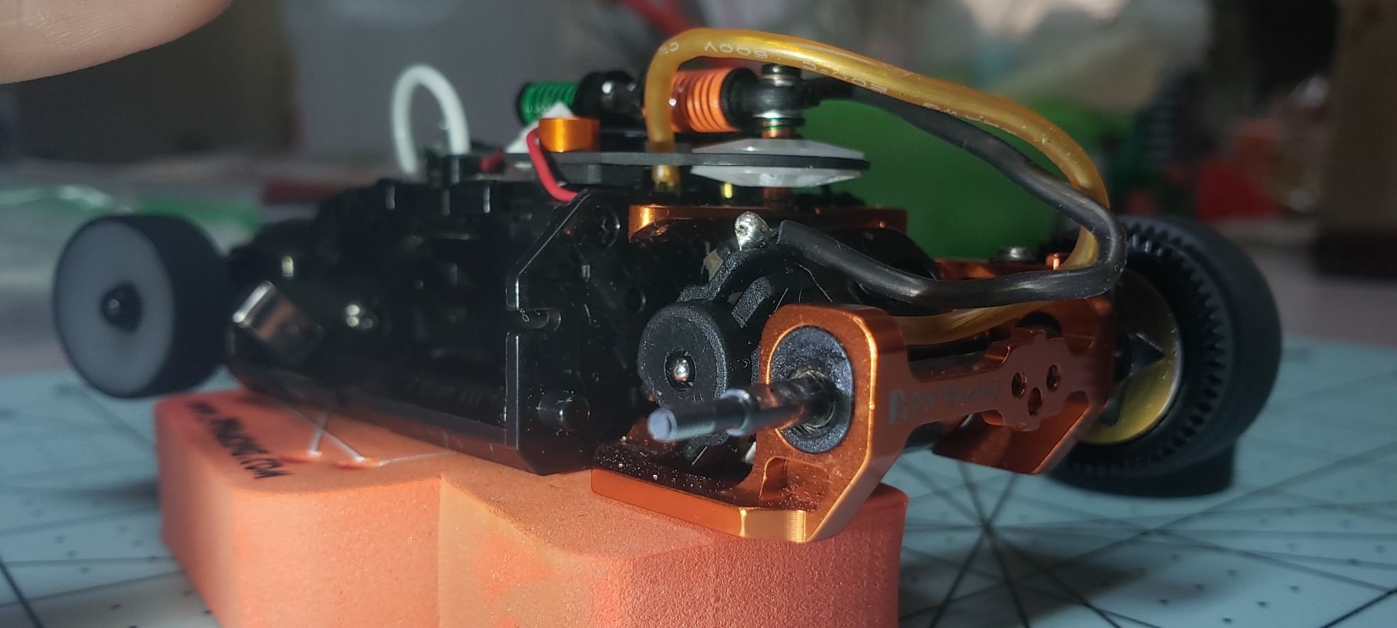

I double checked the bearing holders on both chassis when adjusting the spacers, and they are both in the lower position.
I don't have the cool ride height gauge like you, yet, but my pinion tool from Kyosho is just over 2mm thick, then I use razor blades that are 0.5mm thick to check from there, then use 0.1mm plastic card stock to TRY to get exact. IF I wanted to try to shim the T plate, what is the best material to shim with? I think I still have a broken carbon T plate. Would that work? They are both driving good, but we're always looking to shave time, right.
I couldn't find the larger spacers you were talking about, so I went back to the box my last RTR came in and found a bag of parts stuck to the packaging, and it had 2 of the spacers in it! So on the 94mm chassis I just have 1- 0.8 and 0.5 above the knuckle which leaves me with 2.2mm all the way around. It drives great with no traction rolls or chattering. Hope to get some better times!!!
Yea, back problems just down right suck! I was diagnosed with Degenerative Disk Disease when I was 24 after 5 spinal surgeries in 2 years! So I was put on long term disability and became a stay at home Dad, which was awesome and about the only good thing about it! 20+ years later I'm still walking, but I have to be very careful in what I do, as this disk slipped by reaching to open a drawer at knee height. So finding Mini-z's and Yall are a God send for my sanity!
Thanks Again for EVERYTHING! Drew
p.s. I flipped the bearing holders around. I must have been sleep deprived when I was putting it together.

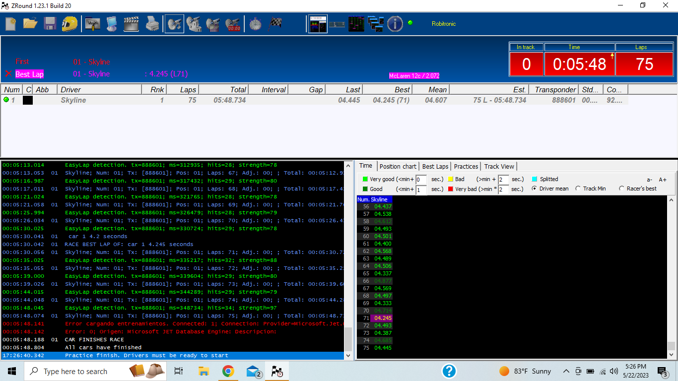

I started painting my McLaren12C, and SkylineGTR33, so I switched my 98mm to a Jomurema and the 94mm to a Ferrari 575 Maranello, and I'm still trying wheels on the Jomurema to get the best handling, but the 575 is GREAT! Ran my fastest lap AND shortest overall time so far!!! So THANK YOU ALL for the help and parts to get me where I'm at, because without Yall I'd still be using half speed on the radio!
Class- Stock
Date-05/22/2023
Location- Central Texas
Race Time- 5:48 minutes / 348.734seconds
Fastest Lap- 4.245 seconds
Chassis- MR-03
Body- Ferrari 575 Maranello
Wheelbase- 94mm
Tires- F- N19mm +1mm PN Dish-Kyosho low height medium / R- W20mm +1mm Kyosho Ray- PN KS Radial soft
Motor- PN70
Batteries- Eneloop 800hv
Front Springs- red
T-Plate- PN #3 Silver Carbon
Motor Mount- PN V3 94-98MM
Dampener (If applicable)- PN MR2061 Graphite Disk Damper- both disks with green springs/PN Dual Center Spring Shock Orange rear/green front
Dampener Fluid (If applicable)- Dry
Gearing- 64pitch 10t pinion/53t spur PN Ball diff
Notes- Car is driving great! Only reversed once this 75 lap stent and FINNALY broke the under 6 minute mark on this layout!
Take Care and Drive Fast!
Drew
