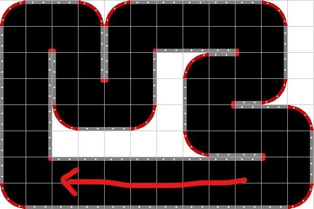

May 2024 Layout
New layout for May, running clockwise. Drive fast!
https://cimg2.ibsrv.net/gimg/www.rct...248920a12a.jpg

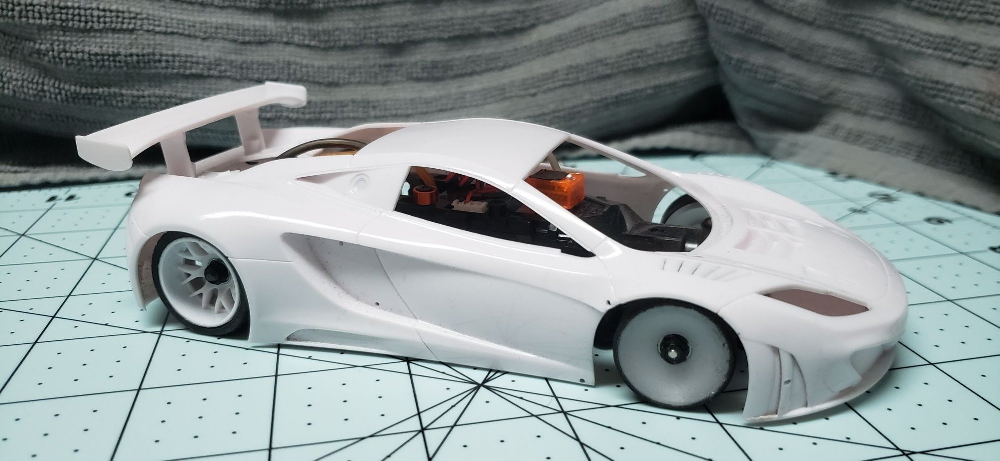

Been running laps with my Stock McLaren 98mm, and the MX-5 90mm Narrow. This layout is really growing on me! The McLaren is really running great! I put 19mm +1N PN dish wheels on the front, and 20mm +2mmW PN BBS rears as Kenon was out of dish +2mm W. The MX-5 is running ok, but I get tons of tire chattering when powering through the corners! I didn't get a full set of lap times with the MX-5 as the batteries died 15 laps in, and the McLaren's batteries were starting to run low around half way, but only cost me about half a second during the last 10 laps or so.
I'm going to start painting up the bodies, just waiting on a few new colors of Cretex to come in! Just about decided on a Gulf Livery on the MX-5, and bright orange, black, and white for the McLaren. I'm going to try to mix up a true Tangello for the orange. It's bright orange/tangerine with yellow pearl. I just am worried my Iwata Neo CN airbrush with it's .35mm needle will have trouble with the pearl. Cretex really recommends a .5mm needle with the pearls unless you thin them.
Anyway here's my times for my Stock Class McLaren.
Class- Stock
Date-05/08/2023
Location- Central Texas
Race Time- 6:09 minutes / 369.361 seconds
Fastest Lap- 4.342 seconds
Chassis- MR-03
Body- McLaren 12C
Wheelbase- 98mm
Tires- F- N19mm +1mm PN Dish-Kyosho low height medium / R- W20mm +2mm BBS PN- PN KS Radial soft
M
otor- PN70
Batteries- Eneloop 800hv
Front Springs- red
T-Plate- #4 Carbon
Motor Mount- PN V3 94-98MM
Dampener (If applicable)- PN MR2061 Graphite Disk Damper- both disks with green springs
Dampener Fluid (If applicable)- Dry
Gearing- 64pitch 9t pinion/53t spur PN Gear diff
Notes- Really driving well! Handling better than I thought a Mini-Z could. I'll have to raise the body clips since going to the 19mm wheels the body is VERY CLOSE to touching the track! ALSO LOVING the PN GEAR DIFF!!! QUIET, SMOOTH and it just works!
https://cimg7.ibsrv.net/gimg/www.rct...a7e7f0f35e.png
https://cimg4.ibsrv.net/gimg/www.rct...8e043aed7.jpeg
https://cimg6.ibsrv.net/gimg/www.rct...0d9e56952.jpeg
