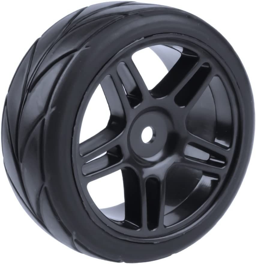

I used 20wt oil in the front of mine with the stock shocks. A little bit heavier in the rear. If the shocks are set up carefully so they have some rebound it handles great w the factory springs. I think it was too stiff before and handles the bumps without bouncing around now. The Reflex is pretty light. I'm not hucking it though more of a long travel roadie set up.
I highly recommend adding diff fluid to all three Front, center and rear. I used 5k/5k/3k respectively. While in there be sure all is assembled properly and lube/replace every bearing to prevent any future meltouts.
I put these wheels and tires on it. They are touch smaller outside dia. so they reduce the gearing a little also reducing motor temps. Get the Eflite cooling fins mentioned above. I recently cut some coling slots to get a little more airflow over the motor. Im still running the 1300mAh 2s Lipo.

EDIT: After receiving my Amazon order of wheels-tires (which I posted links to below)...It seems most if not all of the 12 mm hex interfaces (on the inside of these wheels) are molded at least one mm deeper than on the original equipment 14B wheels. This causes the center of the wheels to rub against the steering blocks and bearing blocks, Doh!!!#$%&*. Unfortunately, it's impossible to make all manufacturers use the same standard. Aaaaarrrrg!!!!
Yeah Kirk, I'm going to order a set of those same wheels/tires in your link above. They have the black dish wheels and a nice tread pattern. Those tires are 65 mm in diameter. I ordered a couple sets of different tread types in this size from Amazon a couple days ago. Also got a set of the taller 'big-knobs' knobby tires that are 76 mm diameter. The wheels they come with are poorly made, there were many bad reviews of the 10 spoke wheels saying they break easily. The same junk I received that came with a lot of plastic flash from the molding process, and the hex interface was molded too deep, so when the wheel nuts are tightened, the plastic around the hex opening rubs on the steering block, and on the bearing blocks on the rear. None of my other wheels have any problems.
I call these the knobby knobs. Tires are great, wheels are junk. (ABOVE)

On the Amazon page for this wheel / tire combo, a few disgruntled customers complained that these tires "ballooned and exploded" during their first test run. I read several others (though a minority compared to all who reviewed them) who had similar experiences. I believe these people did not understand that the tires must be glued to the wheels. Other reviewers seemed to agree with me. How funny is that?
Okay well I'm going to order them and see for myself (65 mm diameter).

Remember to glue the tires to the wheels LOL! I use cheap super glue from the dollar store or anywhere. I wear safety glasses (eye protection) when using it. This stuff can be a hazard if you're not careful. Many people go to emergency rooms every year due to accidents with cyanoacrylate (super glue).

I ran into the same problem with the Contact Brand Foam tire/rims having a 1mm too deep hex for the Reflex, so the easiest fix I found was a sheet of 1mm thick lexan to cut out hex washers to space out the rims to prevent rubbing. The main problem with the added thickness of the washer is you have less threads on the shafts to attach the wheels, so the nylon of the locknut won't reach, but the ribs of the factory locknuts bite into the rims, and I haven't any problems with loosening.

Thanks Drew, I made two spacers from a plastic card yesterday. I haven't tested them yet. The Redcat brand hexes looks like they might be slightly thicker. Need to measure the team associated alloy hexes made for the 14T-14B. I received them yesterday from Amain.
Was worried someone might be disappointed if they bought wheels/tires after looking at my posts from last week. Small brass washers on my Losi Mini-8 work well with the new wheels, but those washers won't go on the thicker 14B axles.
