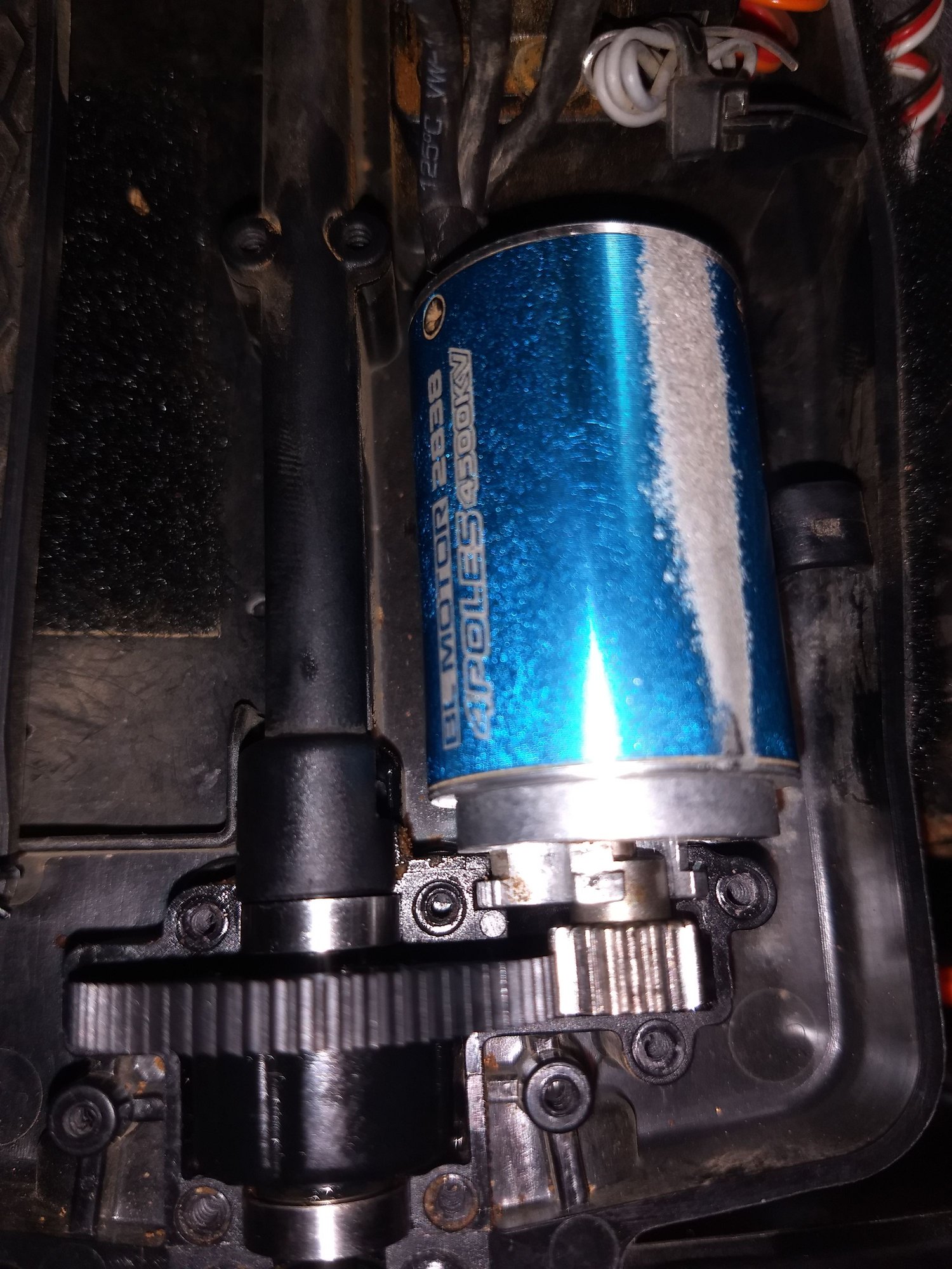

The stock motor runs hot, and there is very little room for a bigger motor. Going to try to fit a 28mm, hopefully we can squeeze it in, but I doubt it. Worth a try though.

As far as the motor goes, you can fit a longer can, but a wider can looks like it might not fit. The stock motor and mount sit really close to the center drive shaft cover. I still haven't tried fitting the 28mm can, really doubt it will fit but I'll try it anyway. Hope this helps, cheers!

Default 28mm motor fits!
So I stripped the stock spur gear today and grabbed the spare 70t out the parts bag. Figured I'll try fitting the 28mm and as you can see fits perfect! Going to order some spare 58t spur gears and try that next. Should run alot cooler and a bit more torque never hurts, I hope lol.

I'd be curious if the LC Racing truggy motor would fit. pretty nice motor.
