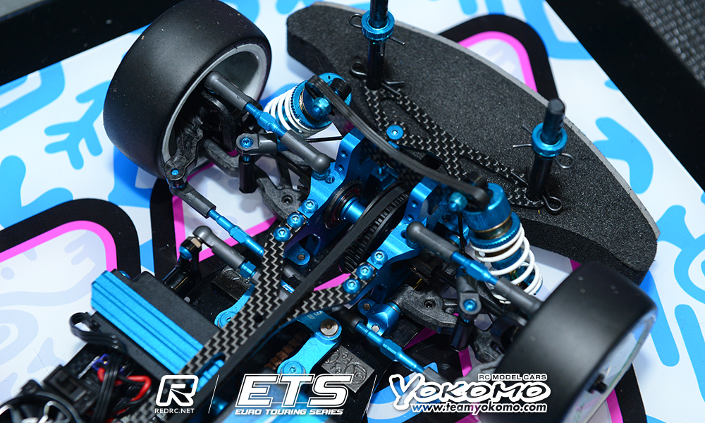

lagcisco 02-28-2015 12:47 PM
My front belt is rubbing the servo mount. Anyone else have this problem and solution?
I've double check the center puller and front spool orientations and they are per-manual.
Only a tiny amount of front spool play so shining that tiny play won't help anything.
The spacers the manual says to use on the actual servo to servo mount can also snag it more leading to the belt getting damaged. That I can remove the spaces but the mount itself still rubs.
cplus 03-03-2015 02:00 AM
I checked mine tonight.
I've had a very mild amount of running too - but then I also noticed a loose screw!
Out with the loctite. Will see if a non wobbly spool will fix it.
jimbojames 03-03-2015 12:03 PM
Same here anyone got a solution
lagcisco 03-03-2015 12:13 PM
I actually ended up flipping the front spool opposite of what the manual said, it helped and also 2 thin shims to move the spool further away. Now the belt isn't bending at the server mount but still a very slight rub that did cause some of the anondizing to wear off the servo mount. Not acceptable Tamiya!!
lagcisco 03-03-2015 12:14 PM
Maybe shimming the actual spool gear from the spool mount would help a little too but I didnt try that.
Brokin Racing 03-03-2015 01:30 PM
When building a new car (especially if it's a brand I'm not familiar with) I always build it once as per instructions, note any problems like the one in above posts, pull it apart again & rebuild and make necessary adjustments.
You'll find you'll end up with a better car if done this way (& always keep a written log)
Just my 20c worth...:nod:
cplus 03-03-2015 01:58 PM
Flipping? How do you mean....? Do you mean the actually pulley in the soool drive? Surely not flip in the bulkhead!
sohlman 03-03-2015 02:45 PM
I used the wider adjustment position of the spool outdrive on the servo side and not the other side. This moves spool towards battery side and gives it plenty of clearance. Hope this makes sense.
Randy Caster 03-03-2015 04:05 PM
I'm intrigued by that as well, cause if it was flipped in the bulkheads, there is no way that it should look right!! Belt would be diagonal and wrap around the servo mount... Hmm.
It'll be hard to stop the belt rubbing on the mount, just due to the proximity of the two, although with two race days with a mod under its belt, no signs of rubbing on my car. And it's all as the manual states.
cplus 03-04-2015 05:46 AM
I can't work out what in these two steps you could do different?
