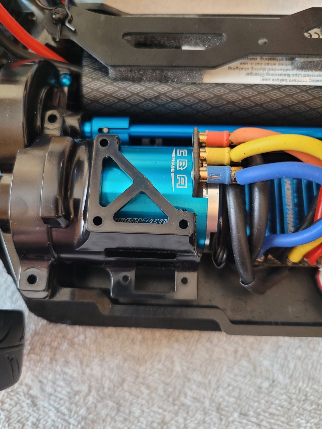

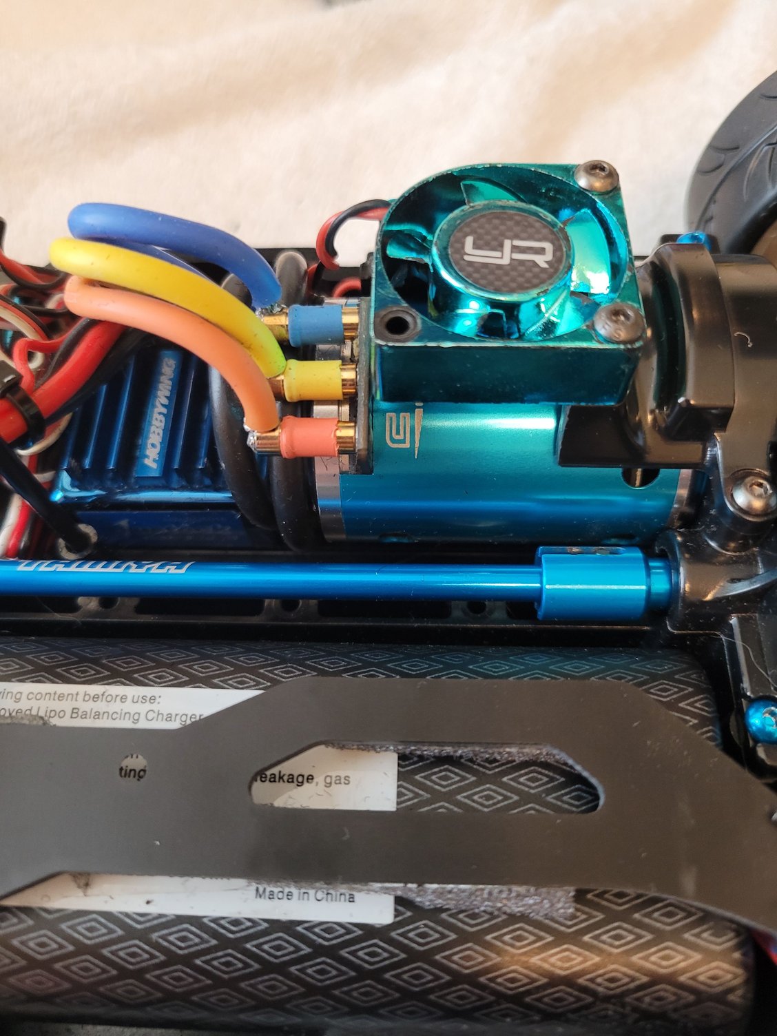

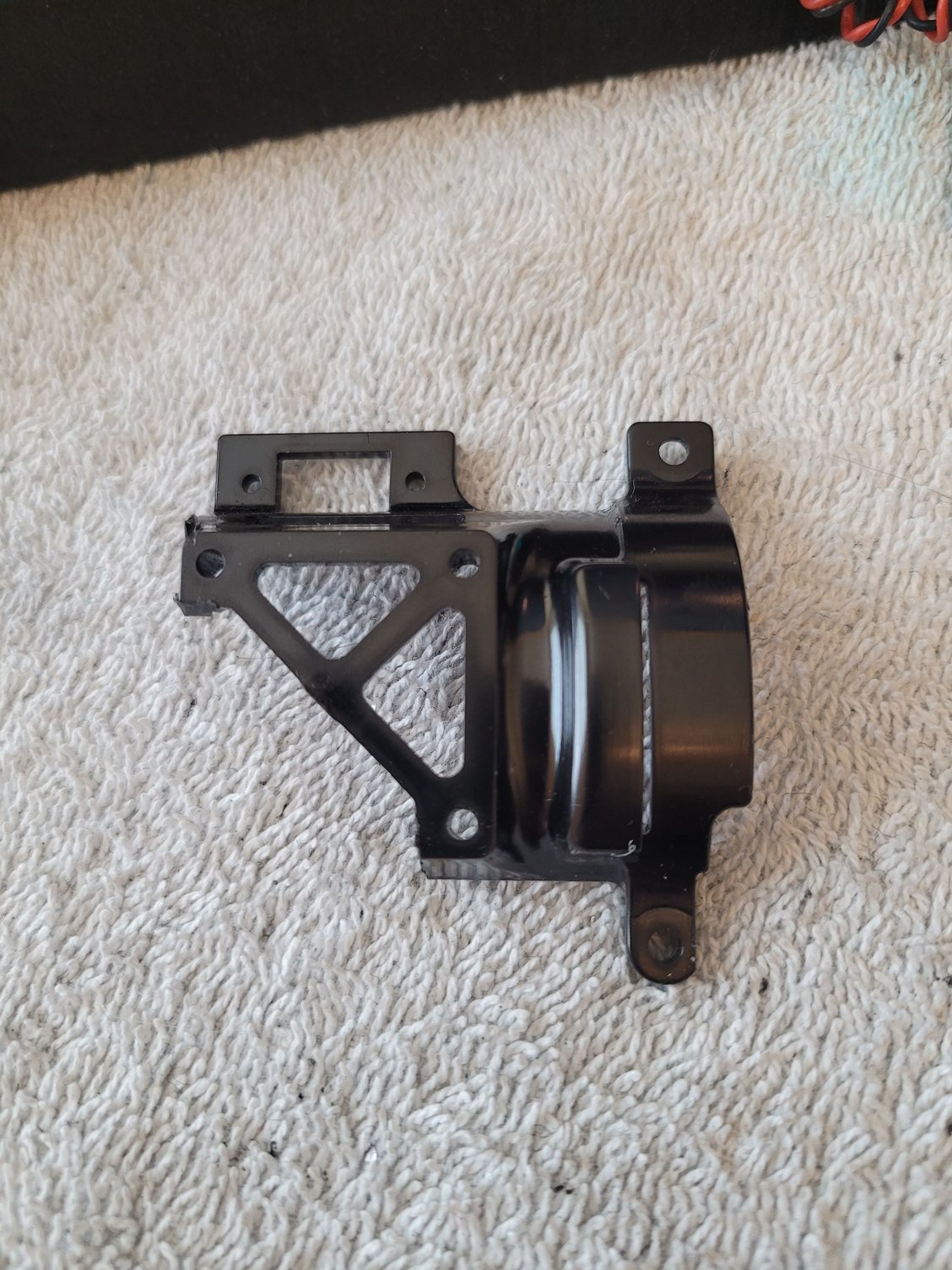

IndyRC_Racer 03-31-2023 10:50 AM
THE MOD IN THIS POST WOULD NOT BE TCS LEGAL
I recently installed a brushless motor into my TT-02s. The fan shroud was hitting the motor wire posts on the motor. I used a spare shroud, dremel, and cutting disc for a quick mod. This only took a few minutes. Basically I cut a corner off and the shroud no longer interferes with the wire mounts on the motor. Here are some pictures of the mod and the shroud mounted on the car.
I probably could have cut less off the shroud, but I thought this modification looked pretty clean.
- motor is a Hobbywing 21.5 sensored/fixed timing that was part of a 21.5/Justock ESC combo (discontinued)
- fan is a Yeah Racing Tornado High Speed Fan # YA-0180BU (30mm x 30mm) (https://www.yeahracing.com/tornado-h...180bu-00030330)
Hope this information is helpful.

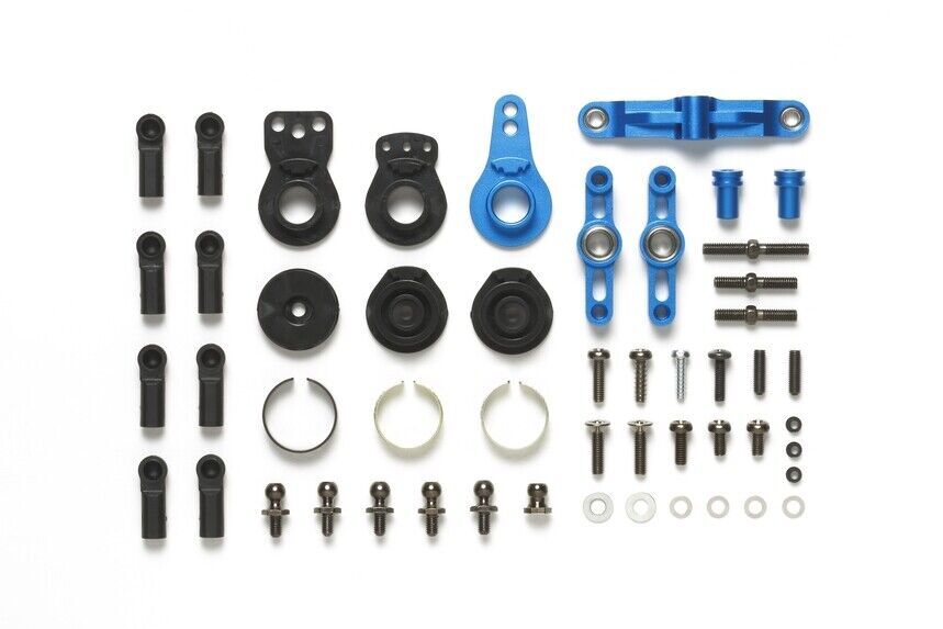

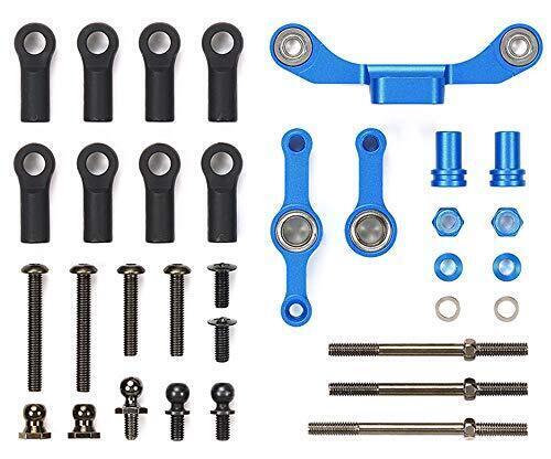

Stephtruc 04-03-2023 11:30 AM
https://zupimages.net/up/23/14/10ax.jpg
https://zupimages.net/up/23/14/nuht.jpg
Hello,
Difference please ?
What is better for carpet ?
Thx

question :
if you are racing TCS ,.the top picture is the TCS legal for TT02R.or RR .
The bottom picture option part is for TT02S only
the bottom pic has the better turning setting for the ackerman set .which is better for track grip condition .top picture is more for stock spec
