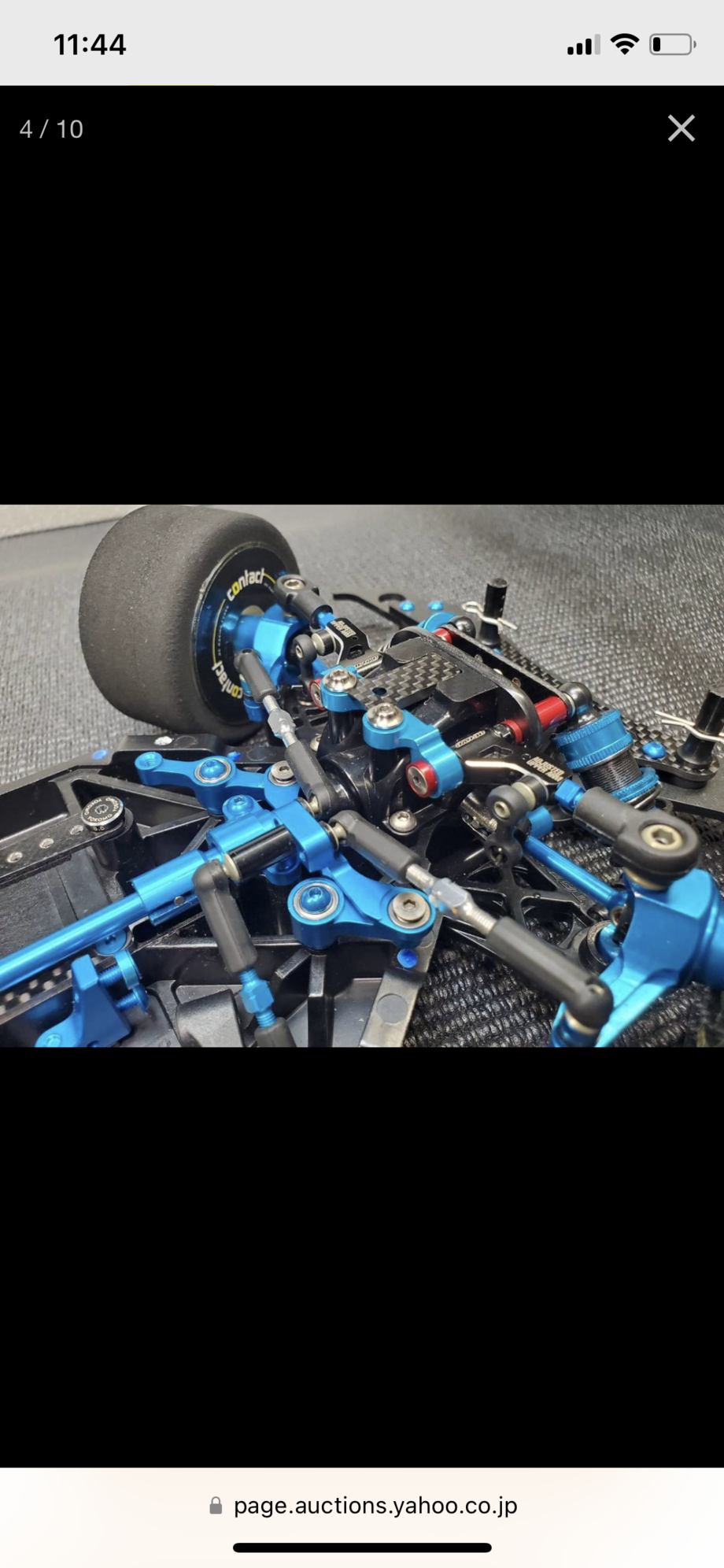

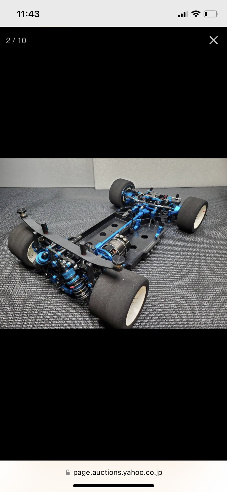

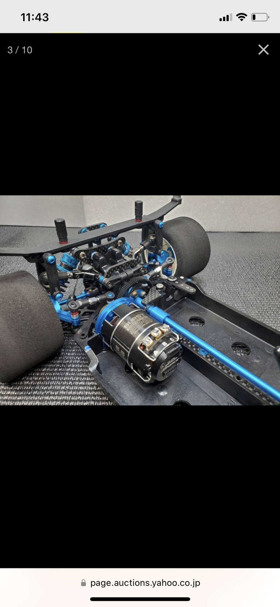

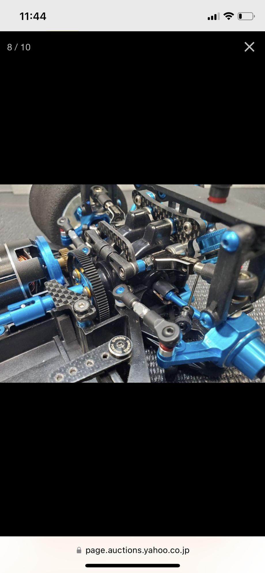

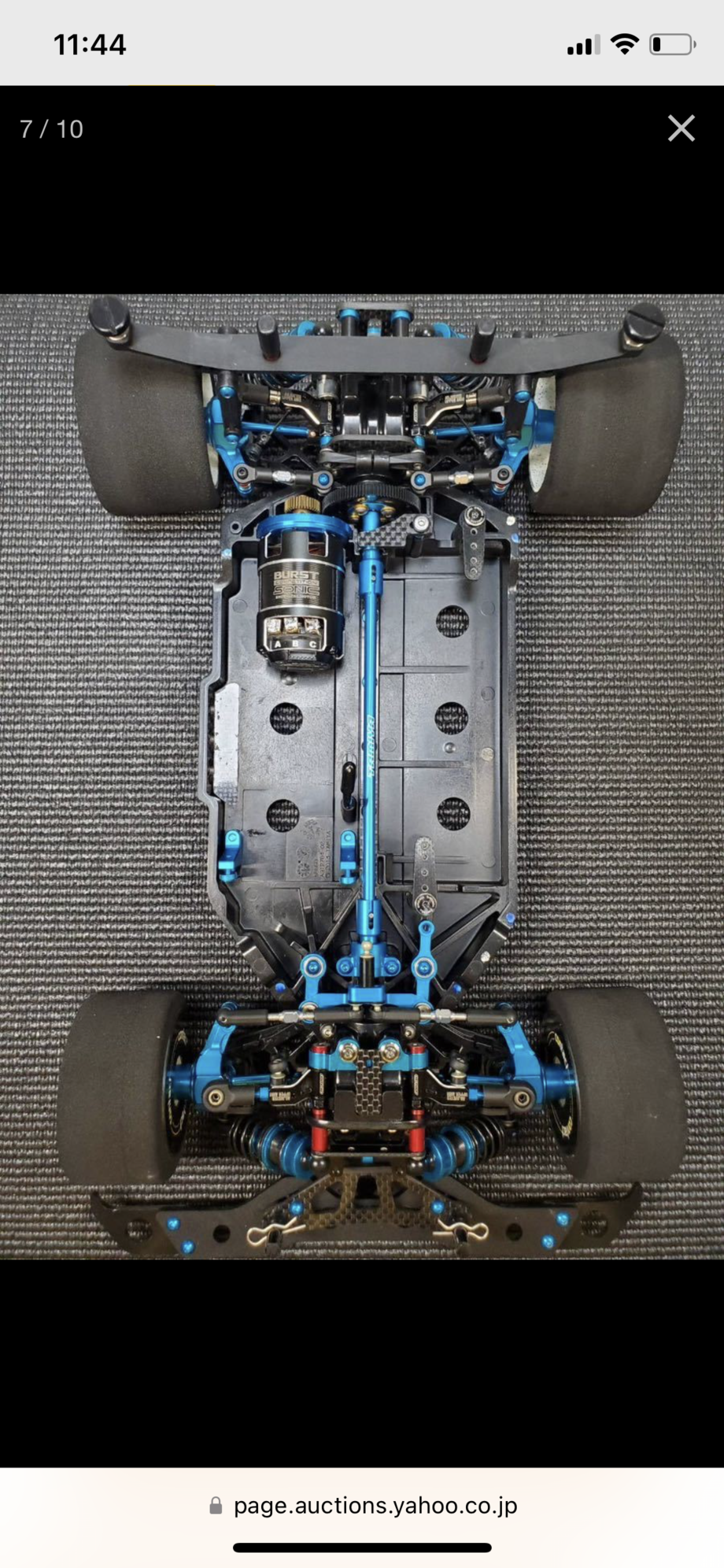

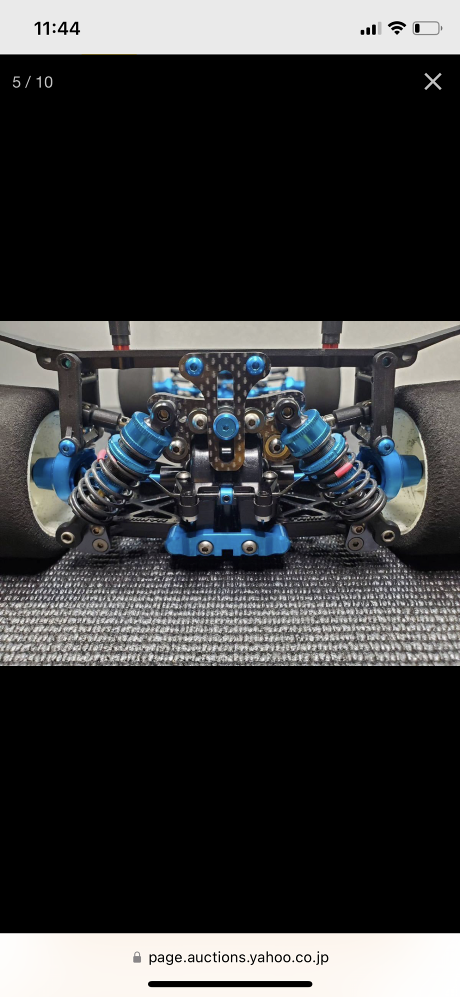

EDWARD2003 10-28-2022 07:50 AM
https://cimg4.ibsrv.net/gimg/www.rct...f650f1fab4.png
https://cimg5.ibsrv.net/gimg/www.rct...b56068b0ab.png
https://cimg7.ibsrv.net/gimg/www.rct...9d7d05011b.png
https://cimg9.ibsrv.net/gimg/www.rct...fd4a546524.png
https://cimg2.ibsrv.net/gimg/www.rct...8c4e2eab61.png
https://cimg3.ibsrv.net/gimg/www.rct...db18b7b6dc.png
https://cimg7.ibsrv.net/gimg/www.rct...d248587557.png
https://cimg8.ibsrv.net/gimg/www.rct...d8af303fbd.png
https://cimg9.ibsrv.net/gimg/www.rct...52909a8583.png
TT02 on the juice
