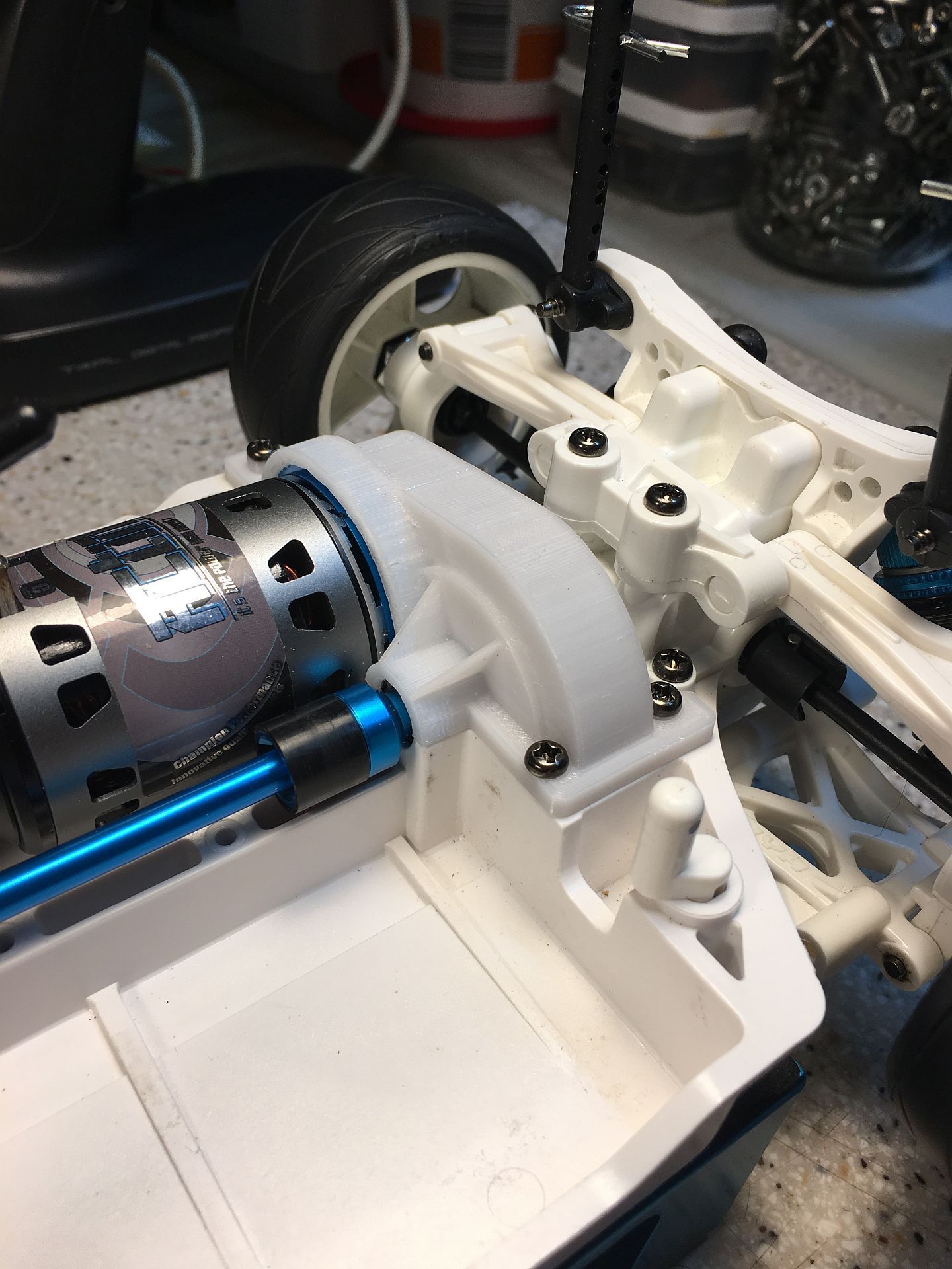

My TT-02 club racer is coming together nicely, but I am still waiting on just a few more parts to make it complete. Coming soon is a nice 25.5 brushless motor, the 3 degree rear hubs and the adjustable upper rear arms. Here is the chassis for now. My gearing is 75/51 that gives an FDR of 3.82 and as you can see I needed to modify the motor cover to allow for the large pinion gear. The motor installed is a Team Powers Actinium 21.5
https://cimg6.ibsrv.net/gimg/www.rct...8e969bfa00.jpg
https://cimg7.ibsrv.net/gimg/www.rct...6be9ca9367.jpg
https://cimg8.ibsrv.net/gimg/www.rct...46ab85ea88.jpg

Check in Thingiverse. There is a modified cover for 3D printing. I did one for my sons car.
SteveM 12-08-2021 04:43 AM
Thanks Eotz, looks to be this part;
https://www.thingiverse.com/thing:4946454
I don't have a 3D printer but will ask around to see if I can get someone local to print this for me.
If anyone out there in TT-02 Land happens to have a stock white motor cover that they'd sell please contact me.
Eotz 12-08-2021 05:22 AM
Yes it is. I don't have a 3D printer either. A work colleague printed it for me.

I found someone local who will print this for me using white PETG and I should have it in a few days. Will post my results.

I printed this out and fiddled with the settings and couldn't get it to fit right. I'd tighten it down and it would snap down by the mounting holes.
EDIT- I have printed countless other parts for my TT02s that fit without issue, but it is a cheaper printer.
So I printed another and cut only what I needed off of it. Cut the stock cover where it needed to be cut, and used super glue and baking soda to fill the gaps and mount. Added a little PS-5 Black to a paintbrush and added to the glue/baking soda.
Now it's not pretty, but it works 😂
Will post a few pics when the sun comes up. Also got the Rallye TT02 buttoned up as well!

The motor cover part was printed and I picked it up today. It was pretty rough, but that might be due to the material and printer used, no clue. The 4 mounting holes did not match up with the chassis and I had to do some milling with my Dremel to get it to fit. Still not perfect and definitely not a 'drop fit' like the kit stock part. It was an experiment and I will run it to see what happens.
https://cimg5.ibsrv.net/gimg/www.rct...998bd9cad4.jpg
https://cimg7.ibsrv.net/gimg/www.rct...596111c921.jpg
https://cimg9.ibsrv.net/gimg/www.rct...bc855b2684.jpg
https://cimg1.ibsrv.net/gimg/www.rct...7c69d401d2.jpg
https://cimg3.ibsrv.net/gimg/www.rct...c4f650b6f8.jpg
https://cimg4.ibsrv.net/gimg/www.rct...db3ea73b54.jpg
