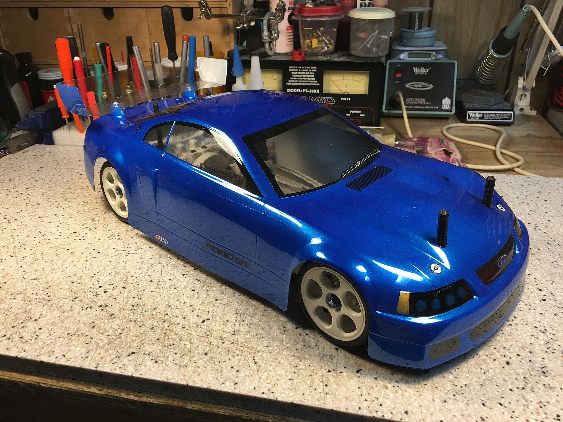

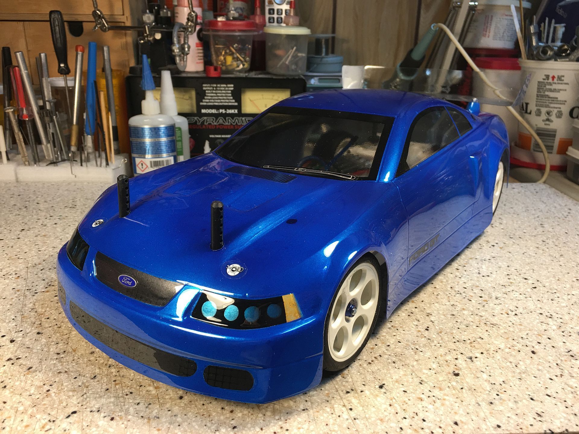

Finding a body for my TT-02 proved to be more difficult than I expected, but luckily a club member had a new McAllister Mustang GT body that he was willing to part with. This is the first McAllister body I've used and it was decent. Standard thickness Lexan, included window mask sheet that was printed but that I had to cut out myself (not precut). There were no stickers or decals other than two McAllister logo ones which was very disappointing for a manufacturer that's been around this long. Thankfully, I had some left over stickers from other bodies I've had in the past and used them where possible. The head lights, tail lights, grill, lower valance and window trim is paint. The windshield wiper, hood grill, hood latch pins, Ford logo in the grill, and the Ford GT on the sides are left over decals from some HPI bodies. It turned out fairly decent in the end.

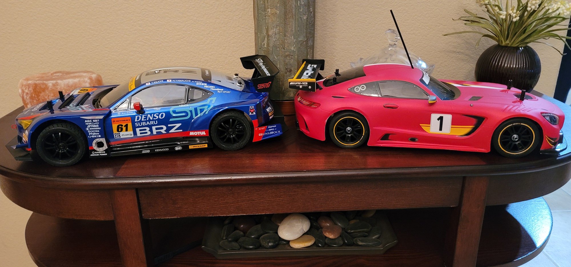

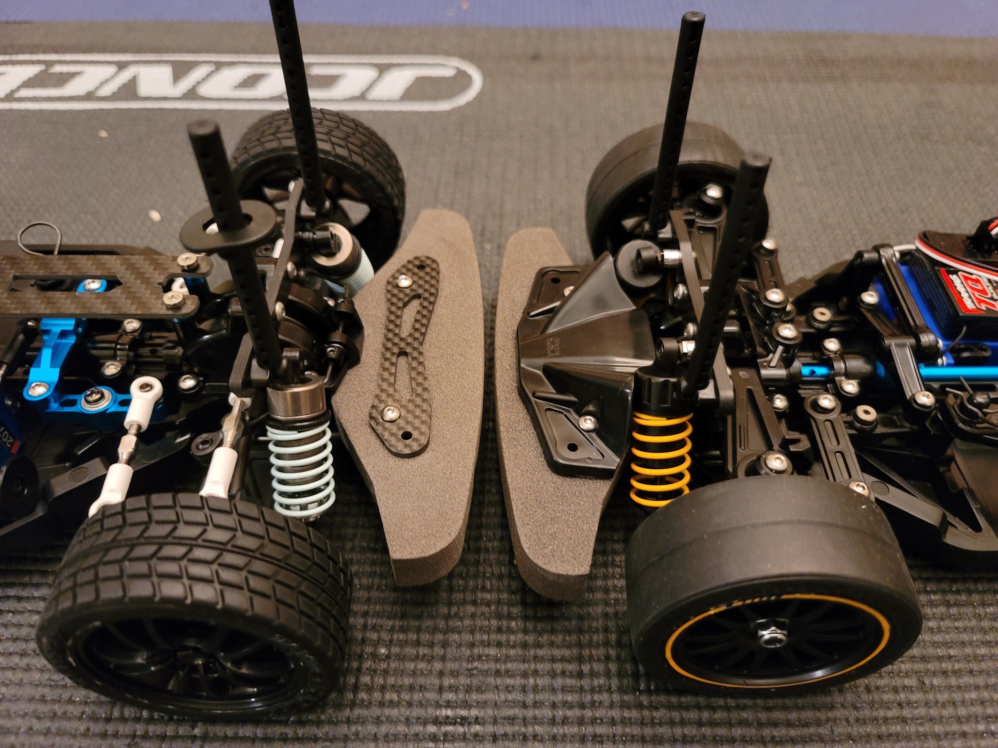

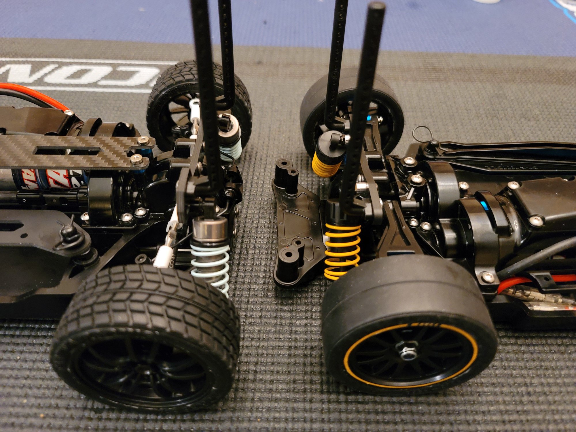

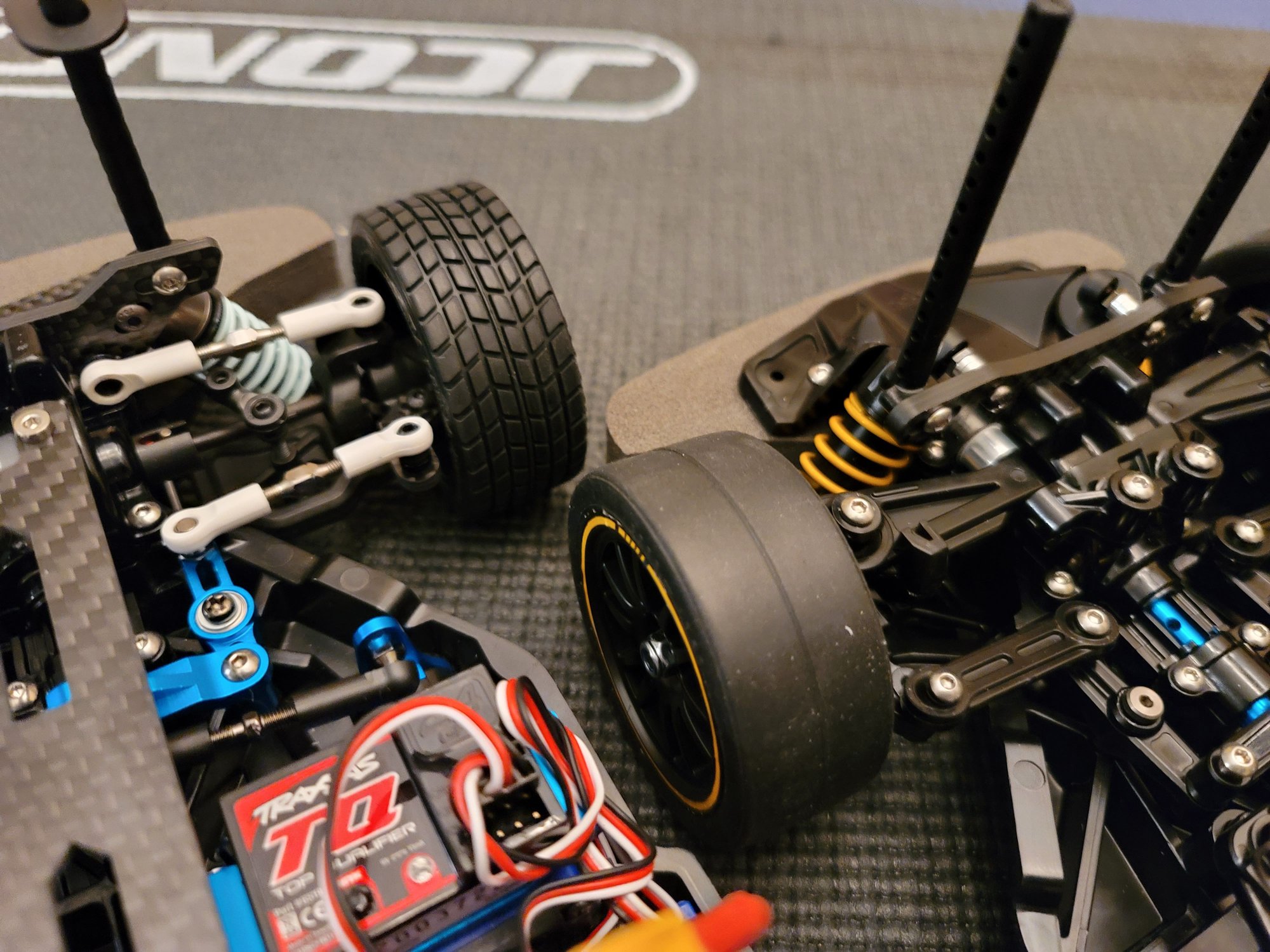

The "Thanksgiving week team TT-02 Building" is complete. Here are the efforts of my stepdad & myself. Now that the TT-02 my stepdad built is the first RC kit he's ever built. In all photos, my car is the one on the left, and my stepdad's is the one on the right.

Panther, the upper control arms are installed wrong on the car with the yellow springs. One is facing the incorrect orientation which is why the front tie rods look a bit strange. Beautiful builds though!
IndyRC_Racer 11-24-2021 12:05 PM
Is that the Yeah Racing Carbon Down Stop Droop Plate on the S Chassis? Here is a link - https://www.yeahracing.com/yeah-raci...t-033-00106030
If that is the Yeah racing part, I may have to get one for my car so I can covert the suspension arms to the 419 upgrade AND be still able to use droop screws. Also what a-arms are you using on the S chassis?
