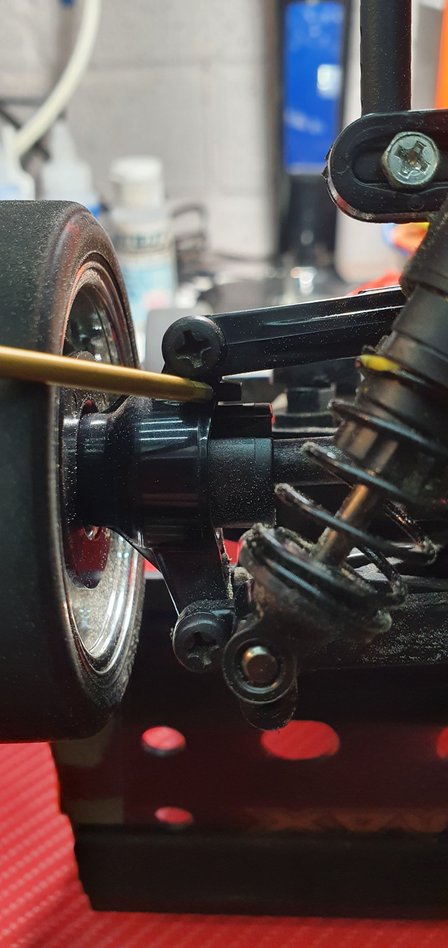

Hi Raman,
My CVAs finally showed up, i was in the process of installing them when i noticed (and i dont know how i never noticed before) that the rear hubs have a travel limiter. I realised the rear has zero droop.
Is this limiter normally removed?
Raman 09-02-2021 10:23 AM
Originally Posted by Monsta (Post 15819996)
Hi Raman,
Post a picture of these limiters
Monsta 09-07-2021 07:10 PM
sorry for the delay.
These are the limiters, depending on if you have it set high or low. They contact the lower arm at droop/when load is off the wheels.
In my case the were in contact at normal ride height.
https://cimg4.ibsrv.net/gimg/www.rct...1fbcbeea87.jpg
I ended up cutting the bottom ones off. now with CVAs and 1mm front and 2mm rear droop it feels better on the driveway. I have to wait until our current lockdown ends to see if its better at the track.

Monsta 09-13-2021 04:09 PM
Hi Raman,
These are the limiters on mine. are they not on all variants of the TT02?
https://cimg8.ibsrv.net/gimg/www.rct...79ccf11ff6.png

Raman 09-14-2021 07:33 AM
Originally Posted by Monsta (Post 15823842)
Hi Raman,
No, not on the type S. I think those limit the movement to stop the dog bones from popping out. They’re not for droop. For droop you would place inserts inside the shocks, eg 1mm spacers, 2 mm spacers. A royal PITA but that’s the TT02 suspension lol.
