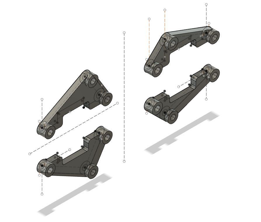

hprt 12-18-2020 09:04 AM
Droop limiters for 54874 upper arms
For those using tam 54874 upper arms, I designed droop limiters for the TT02. If you want the .stl file for printing, PM me.

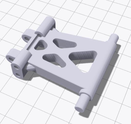

simple 12-29-2020 01:59 PM
Has anyone successfully stretched out the suspension to accommodate a 210mm body (Yes its 210, not 200, its a Kyosho Ferrari 575 GTC LM)....?
The widest I have managed to get my TT02R thus far is 190mm using the 50808 long axles.......
I'm trying to avoid using the 12mm wheel hex hub adapters because then the geometry gets really funky...If there is a way to extend the suspension...I'm all ears.
Any one attempted this experiment already?
Nerobro 12-30-2020 07:10 AM
I believe the arms themselves are on thingiverse. Use your favorite 3d modeling program to add a few MM to each arm, and get some longer turnbuckles for the top?
simple 12-30-2020 07:31 PM
Can't believe I didn't think of that., thank you.
Those files aren't up to my standards, but thats the direction I'll take. I'll draft them myself and find some suitable length driveshafts....
simple 01-07-2021 10:08 AM
Whipped these arms up to increase the the width by 10mm overall (5mm per arm) for a first kick at the can.
I'll take some pictures once the printing is complete next week.
