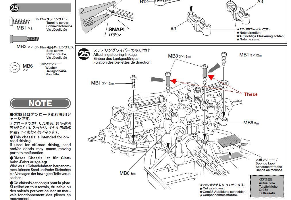

zaraz 02-10-2020 01:59 PM
never saw an m3x18 screw on the tt02
SteveM 02-10-2020 02:06 PM
Part of the steering assembly.
https://cimg3.ibsrv.net/gimg/www.rct...ae725c1b99.jpg
zaraz 02-10-2020 02:48 PM
aw that clears it up, I was looking for a normal screw not those ones got me a little worried as I just built one and did not have the m3x18 screws, if you replace the kit ones with regular screws you would need some sort of flanged tube to go n place.

sethwas 02-11-2020 11:30 AM
tamiya makes a hex replacement for it anyway which tightens up the steering a hair.
