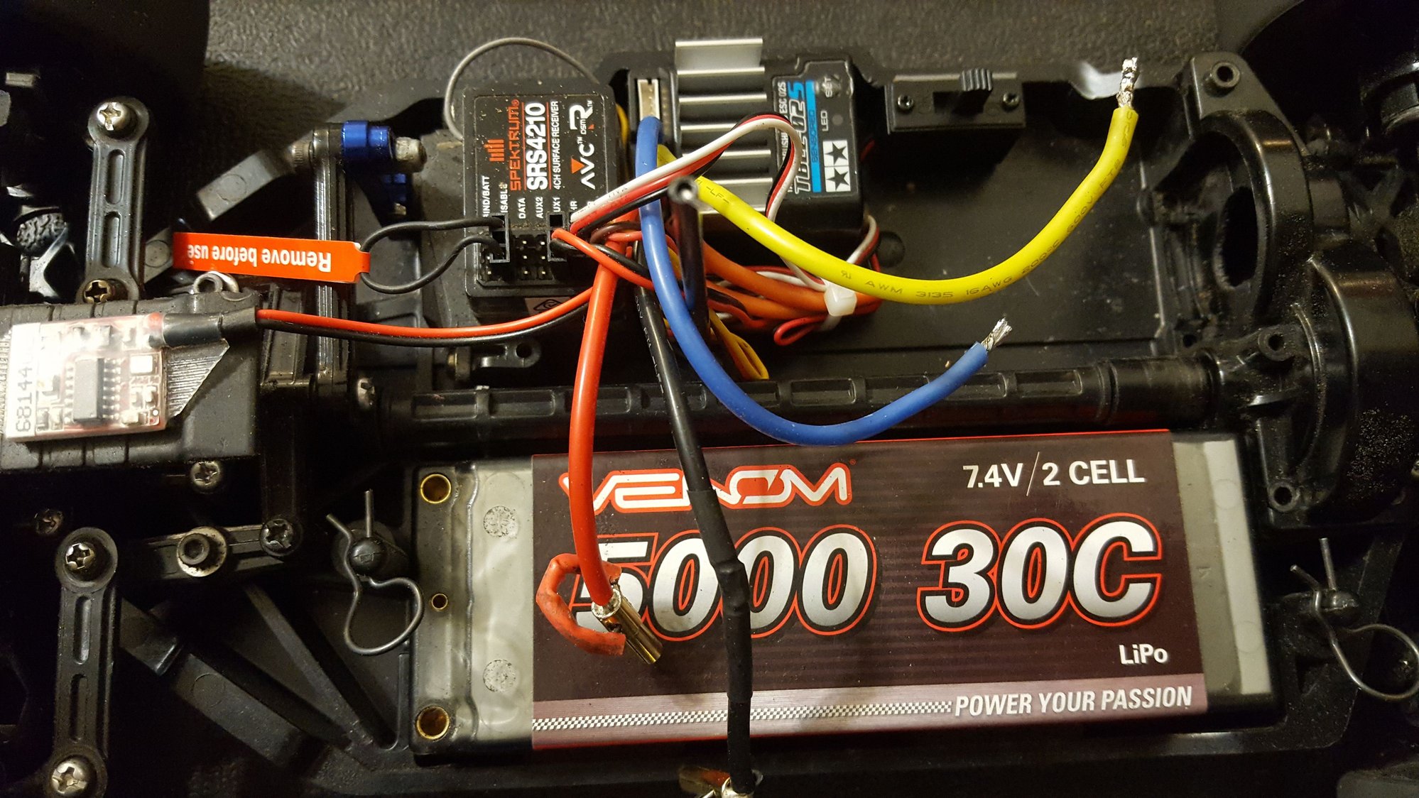

I have a tt-02 with the tble-02 esc and brushed motor that came with it. Using a Spectrum DX4C radio with the AVC traction control reciver. Worked fine for few weeks. Now the ESC stop working started blinking red and then went up in smoke. Tried another tble-02 ESC and noticed it getting hot just plugged in. Then I installed new motor. The LED on it turns green like it should when using it, but now it only has brake and reverse. Not sure what to do next. The LHS told me it could be the AVC reciver or because I removed all the tamiya plugs and soldered a better battery plug and directly to the motor. I used that reciver on 2 other cars with no problems. The others were brushless. I checked voltage at motor ends. Full throttle went to about 11v then back down to about 6v. Brake about 6v and reverse about 3v. Anyone have this problem?

Changing plugs would not cause these problems. I’m not familiar with the AVC receiver but I’m guessing it’s probably the culprit. To be honest you don’t need traction control. Between my son and myself we own 2 dozen RC cars, 8 of which we race.. none use such a feature.

11v? Are you trying to use a 3s battery on a 2s speed controller?

It's a 5000 mhA 30c 2s. Thought the 11v was some boost from a capacitor in the ESC. It very quickly went back down to about 6v.

That's not how that works, and the TBLE02 only has a linear regulator for BEC. 11v is still concerning. I don't know where that would be coming from. Want to post a photo of your setup?
I did insert the bind plug in AVC disable plug after all this started to see if it would help. Didnt work.

I wired it like this before the problems started. This is my other one with a different servo.
