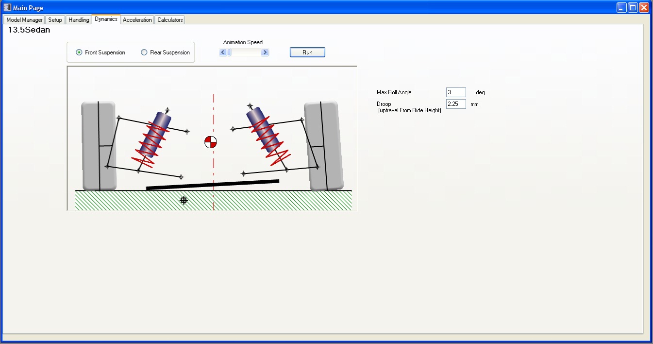

Thought a preview of the new suspension Dynamics feature that's in work would be appropriate. Still have some work to do but you should get the idea.
I've included a screenshot and a link to a quick Youtube screen cast video.
http://www.youtube.com/watch?v=4ieFtfne_xw
