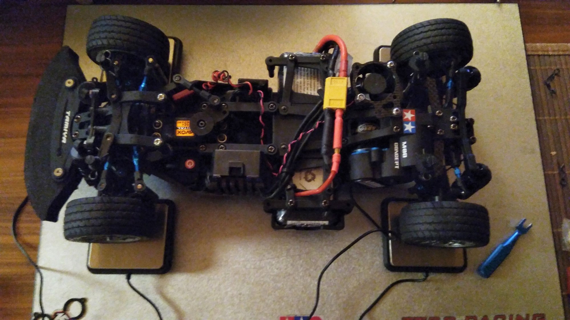

Just wondering has anybody put their car on four scales or a tweak board ?

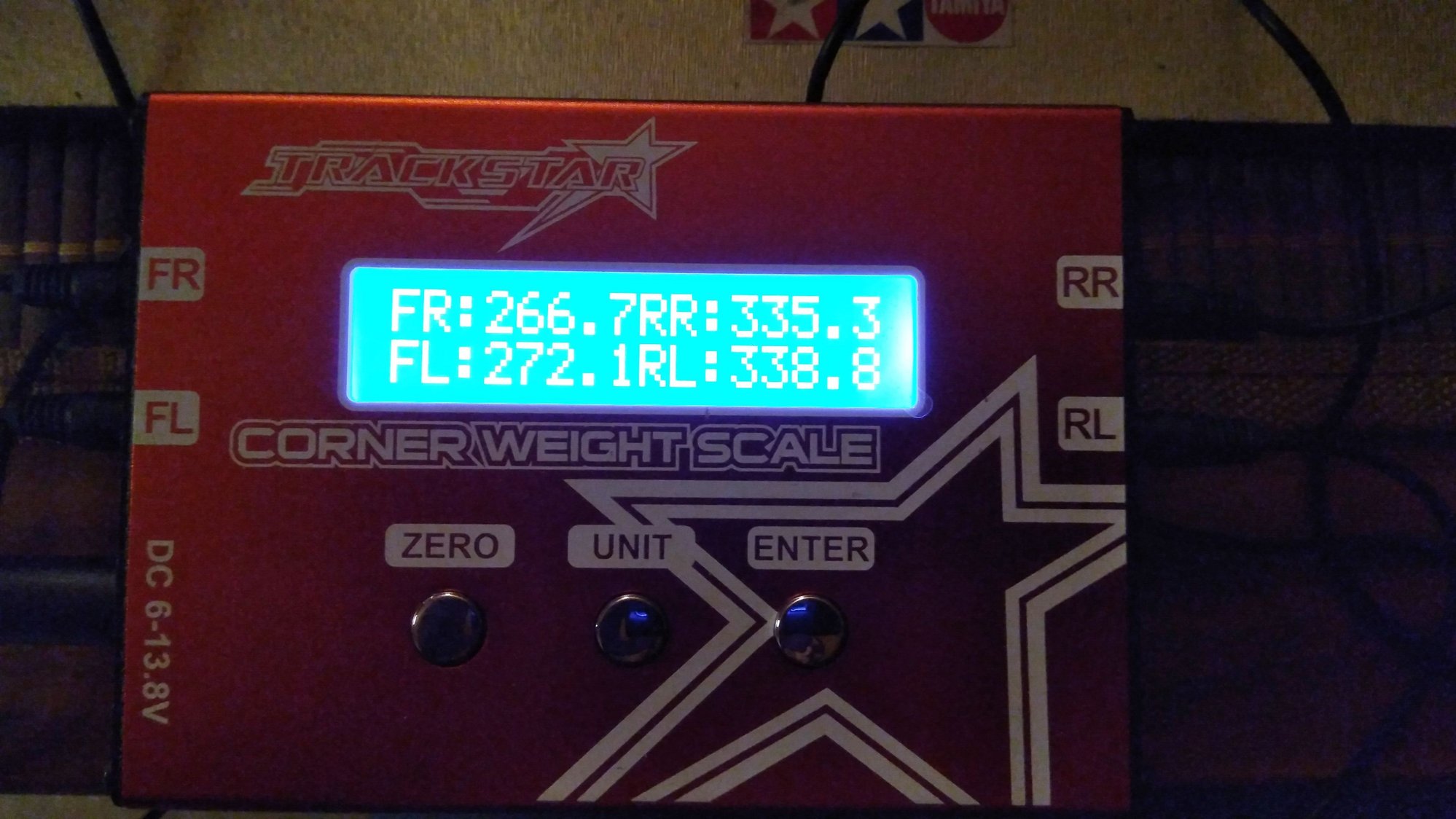

I put mine this week on a Corner weight scale after my first real race. Had a bit of Problem starting from Zero in the starting grid, pulling to the left side. But I had been lazy and didn´t have the M08 balanced yet. As we use the Carson Dragster 3 ESC there´s quite a heavy load to be equalized. Nearly all my Friends put the ESC on the opposite side of the engine, to balance already by the location. I now put my Receiver on the right side plus 15g tire balance weight. With CVA dampers I Chose the way to put 0,5mm shims above the lower ring eye under the spring seat. By that I got now a acceptable balance with less than 10gr. difference left to right on each axle. Good enough for me.

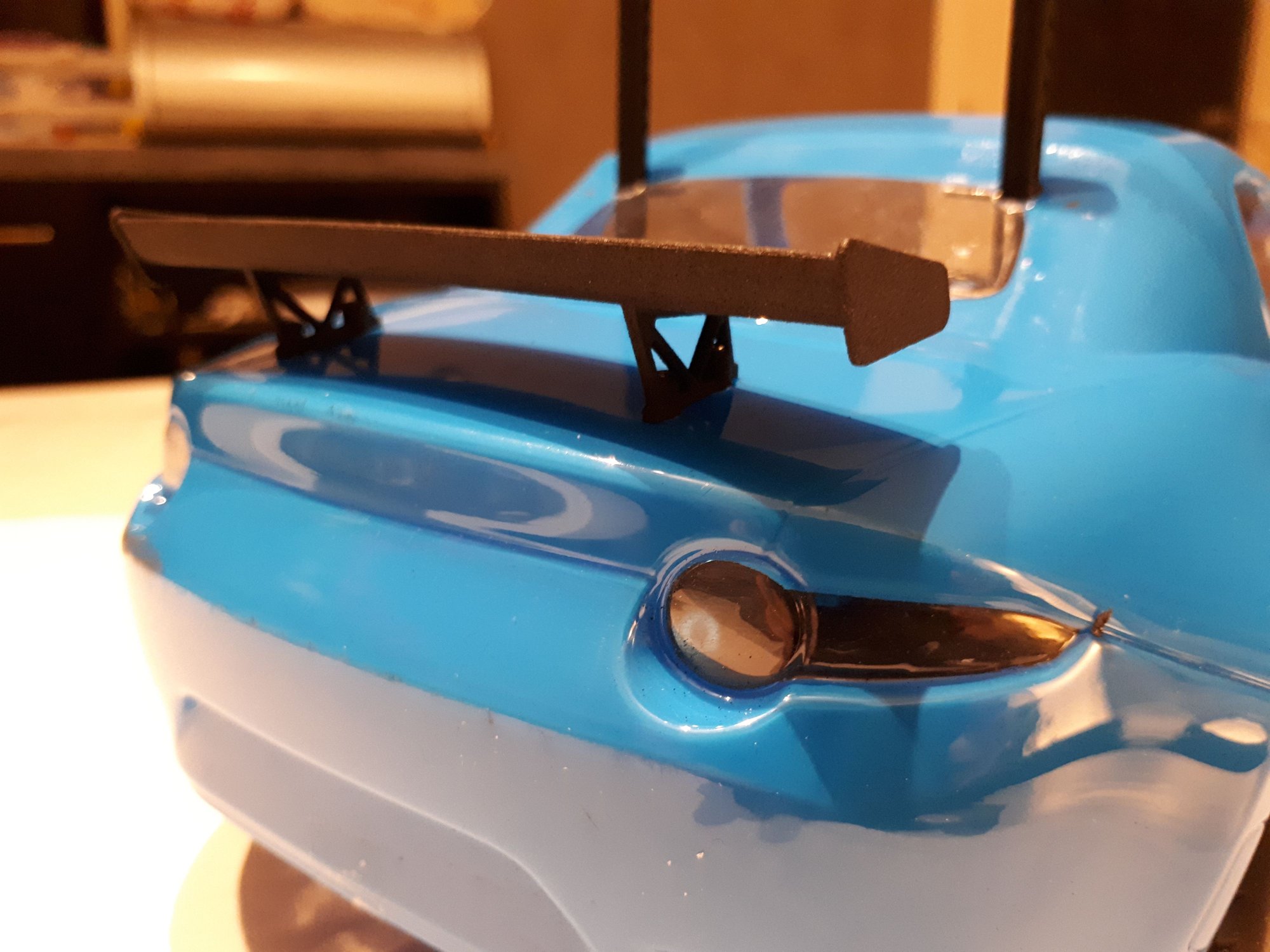

Today i had my first run with the M08 and the car is a blast to drive. Allthough my M07 runs also great and fast but i've been 0.4s faster with the M08 over the M07 at the same strack layout. No gleuing on the front tires and with the exception of a anti-roll bar the car is as good as standard.
Grip level is medium to high.

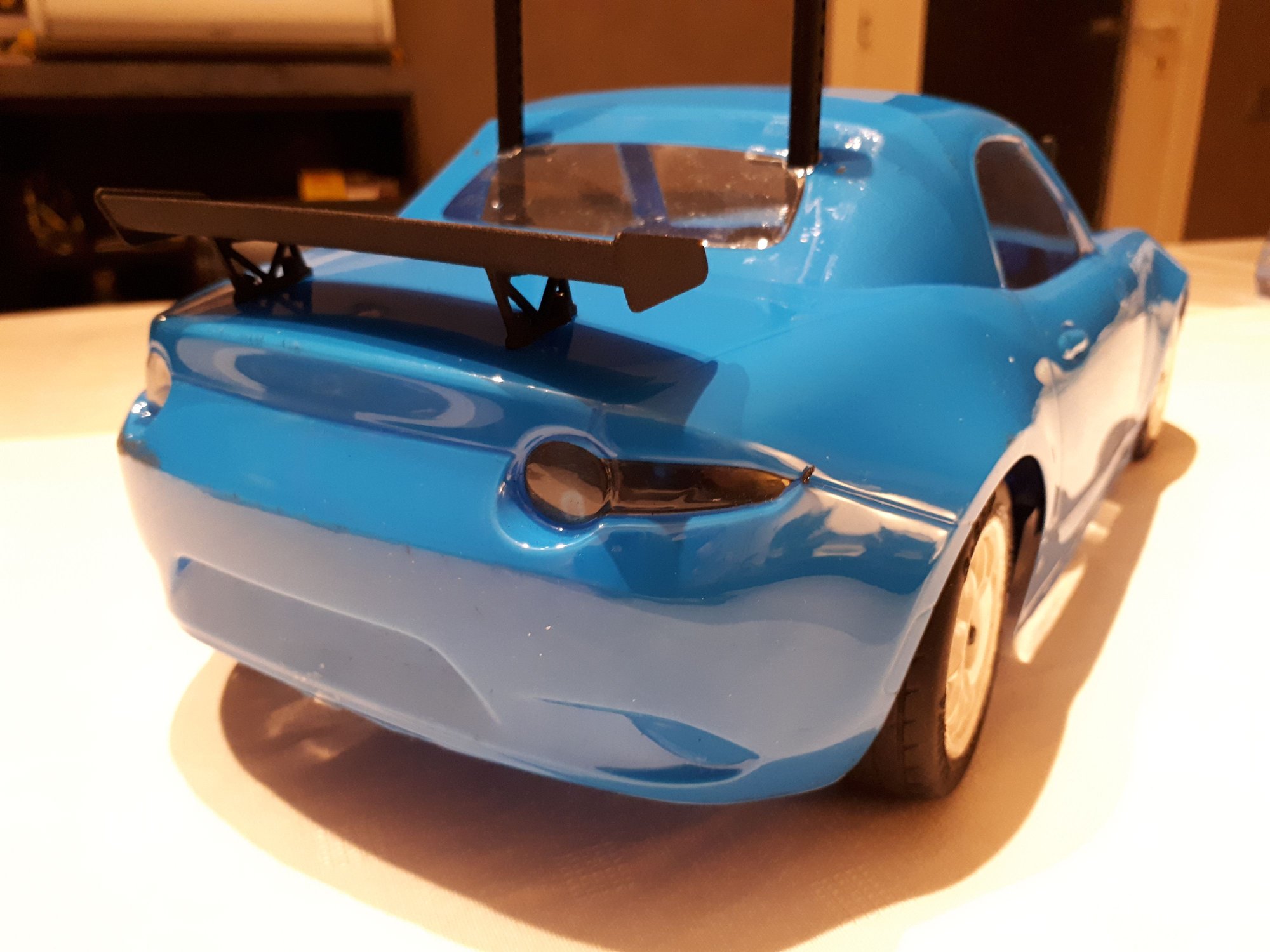

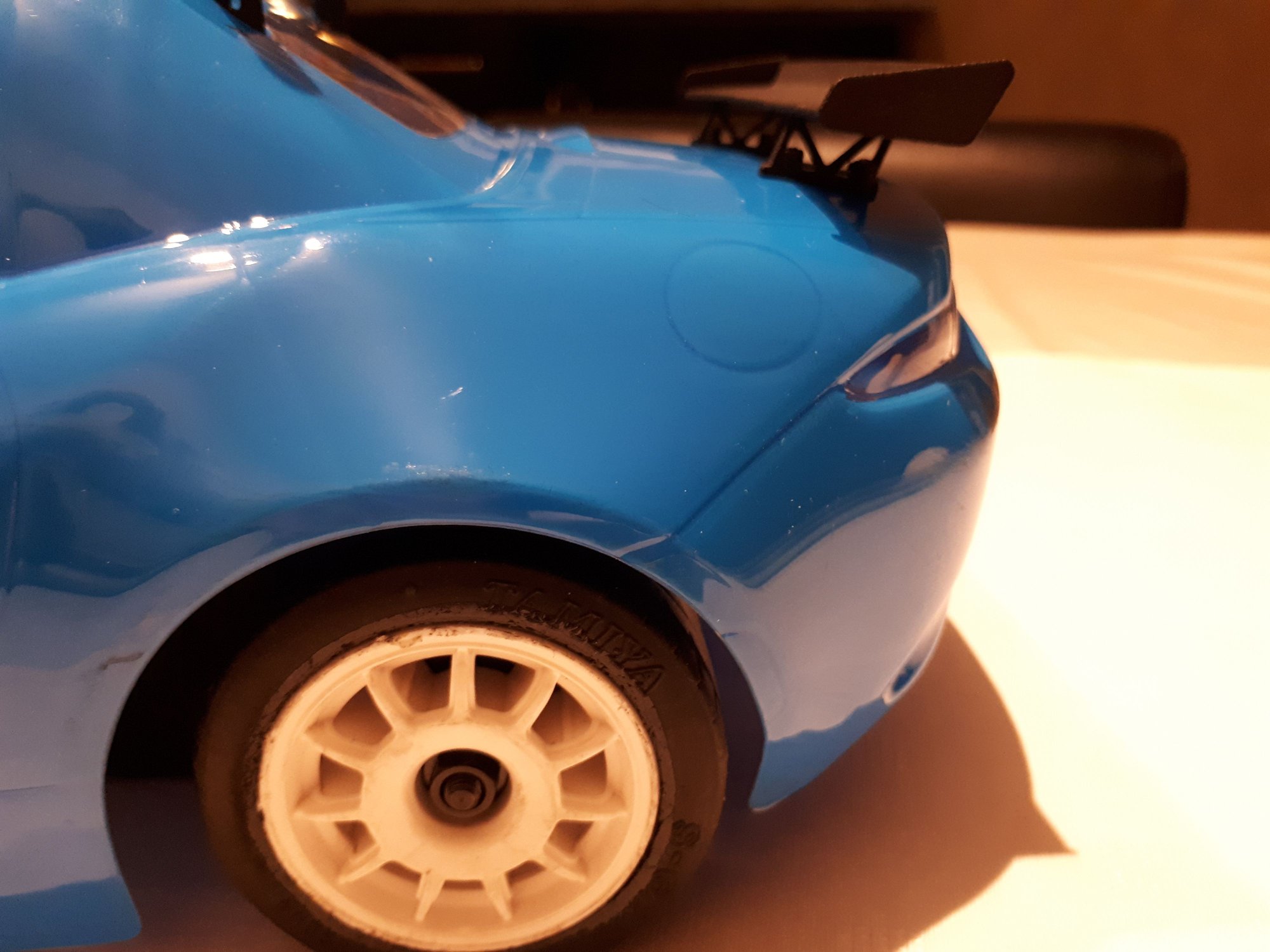

I've also been busy with designing and 3D printing a rear spoiler for the MX-5 and it hold pretty well even though i've been hit from behind it's still in 1 piece.
The whole idea was to design a spoiler that looks as real as possible and it worked out very well (i think) :-)

Very cool work! Looks really scale on the MX5! Which stabi did you use?

Soft at the rear
