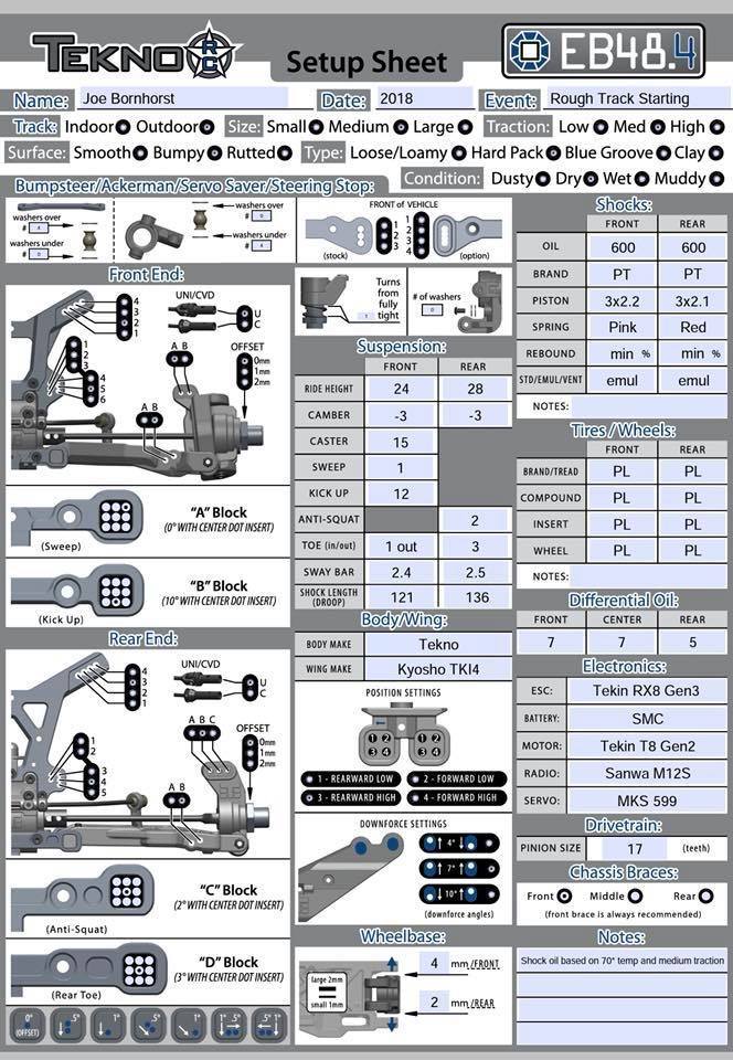

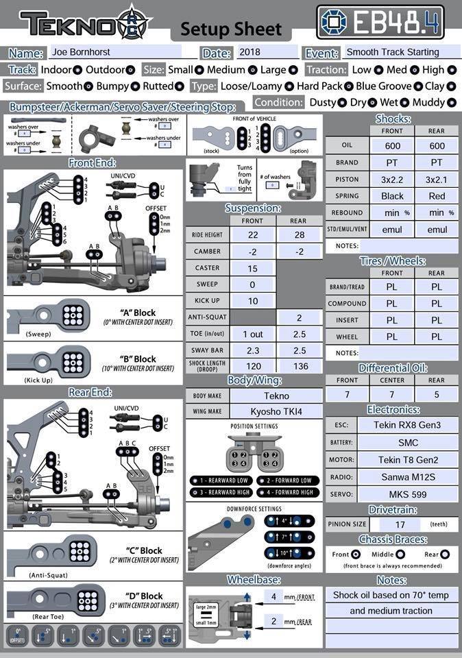

Just wanted to give a little feedback on the current generation of setups. The smooth track setup is where you want to start for 90% of your tracks. If you can't handle the bumps, then you'll swap to the rough track.
For the smooth track setup, a few of us found it has a small push in the middle of the turn. This isn't a bad thing as it makes the car a little easier to drive without sacrificing speed. If you feel that you need a little more steering, you can move your front hubs forward and you'll have a ton.
The ackerman is missing from the sheets. It should be middle dot for both.
https://cimg6.ibsrv.net/gimg/www.rct...c83329e614.jpg
https://cimg7.ibsrv.net/gimg/www.rct...92d5c585d3.jpg

how would 100 degree temps affect this shock oil of choice?
i am running the rough track setup except full kickup
I have slight push no power in turns low to medium traction
at night when moisture is in its perfect
thanks
Munnster 06-19-2018 03:00 PM
These setups are based around 70* temps, so 650 to 700 shock oil would be a good place to start for temps approaching 100 degrees.
Bob Barry 06-19-2018 03:41 PM
yea like Jesse said, Rule of thumb is 50 cst for every 15 degrees. Remember it's not an exact science so you'll need to experiment some. The team just did the legwork to get you started :)
