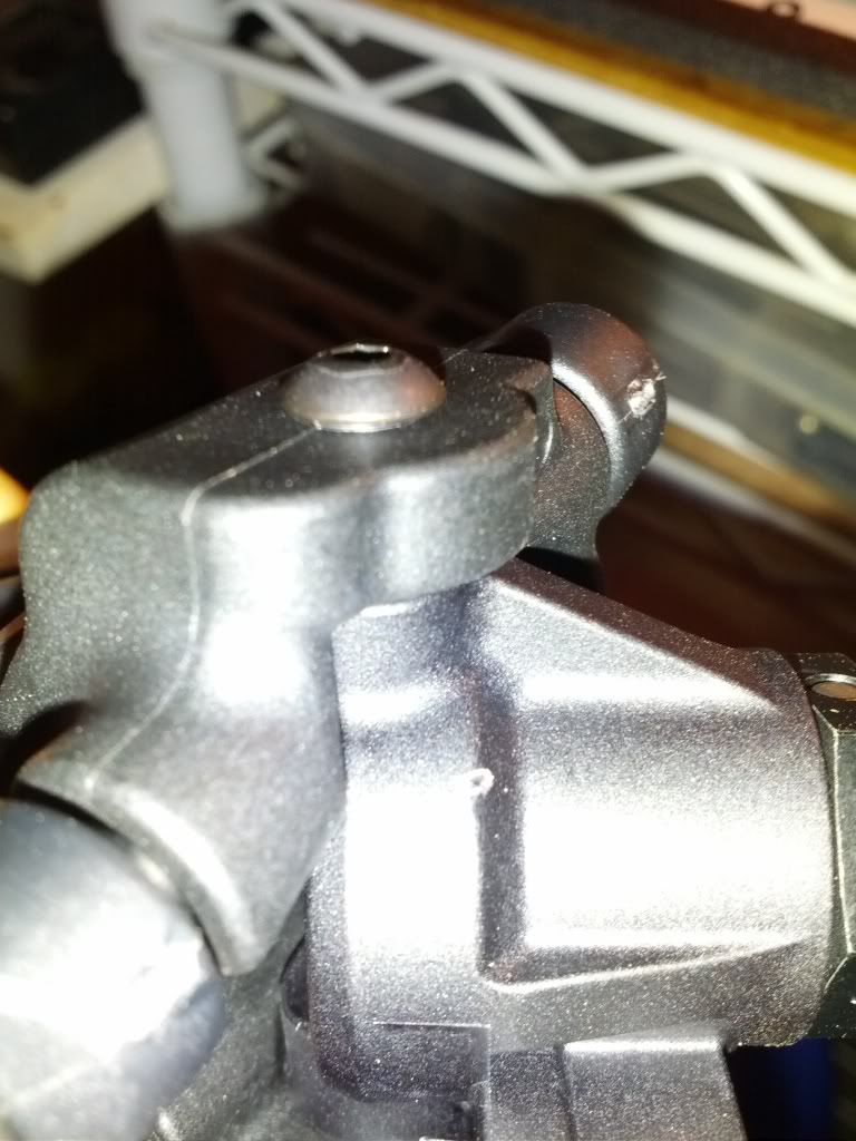

The steering is locking up far right and left, how far should it turn left and right?
http://youtu.be/iYpsA9wzU8A
Heres a video, not the best, camera phone and not great lighting.
Pleaes tell me if its supposed to do this.

The steering issue is fine if you look at the knuckle you can see a little mark on it, if you choose you can take a hobby knife and trim it down to make it not rub anymore or just leave it and it will break itself in and make a groove in the plastic and won't bind anymore. The problem is the M4x18 is about a mm to long so the spindle touches it causing the binding.
Before making the groove with hobby knife:
After making the groove and no more binding:
