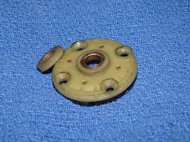

Originally Posted by LouDawg
Any updates on the 5x10x3 Bearing mod to help fix the diff outdrive slop??
I want to know if its a viable fix before I chop up my diff cases! Lol
Thanks
Have I missed something about the 5x10x3 bearing mod? I keep up with this thread and can't find this.
Here it is
Originally Posted by B ELDRIDGE
I think I may have found a way to fix wobbly diffs. You cut down where the 10x16x4 bearing rides to about 1.25mm tall, then you can place a 5x10x3 bearing(AE91156) inside the other bearing for the outdrives to ride in.
Attachment 856485
Attachment 856486
Attachment 856487
Attachment 856488
or it's here on this page 921:
http://www.rctech.net/forum/electric...l#post10114703

So who has actually tried that mod?
