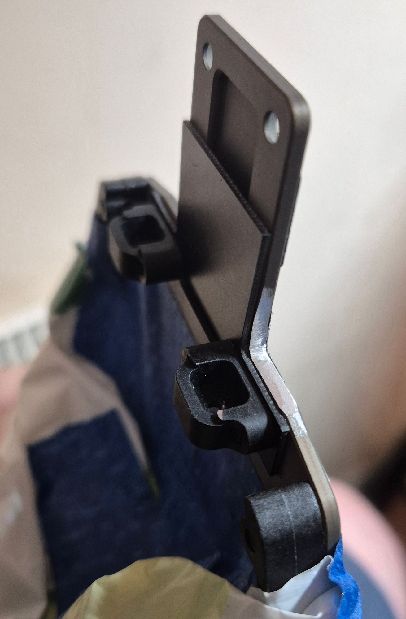

Just fitted the laydown servo mount here, not had chance to run it but it's a bit difficult getting the servos screws in. I have to revised Aerox servo arm and just need to lightly Dremel away the under side of the top plate for clearance, a bit like the b6.4.
Feedback I have received from others that have run it, is it slightly less positive on initial turn in. Will see what it's like when I hit the track next time out.

Had a short test session with the flat servo mount yesterday, I didn't back to back it but it feels much smoother transitioning from straight ahead to turning, and then taking off lock to straighten ahead. Made the car very smooth and easy to place on the track.

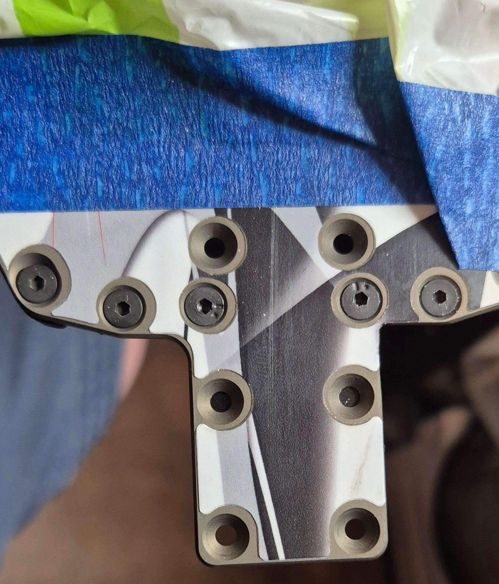

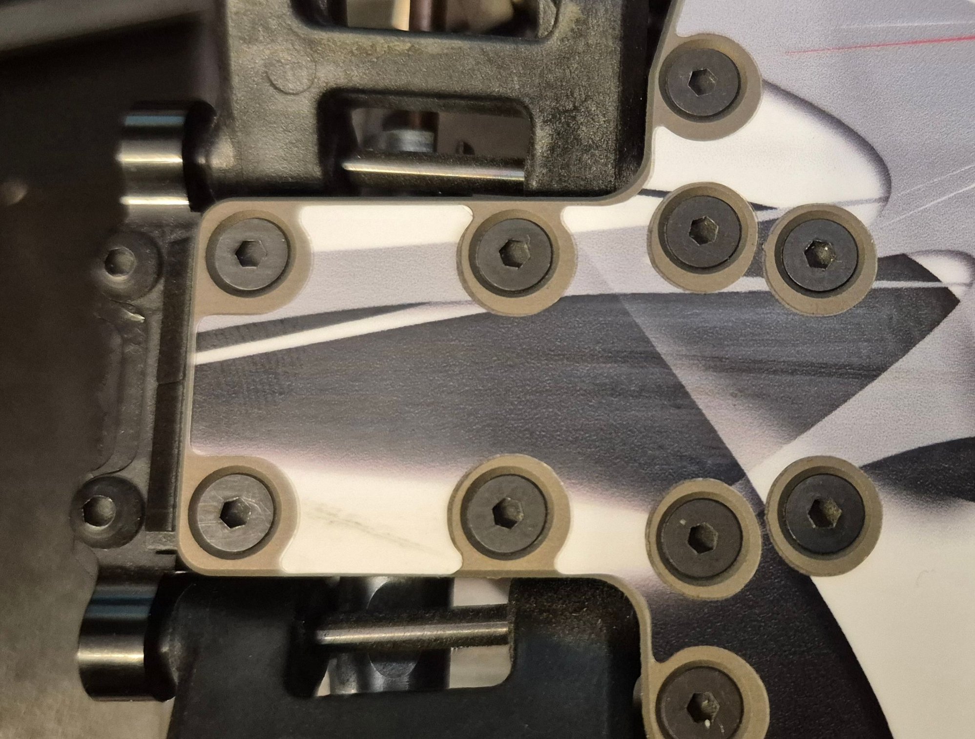

Did you dremel the chassis as the instructions suggest for low roll centre settings?
dvaid852456 is offline
Old 05-01-2026 | 02:47 AM
  #685
dvaid852456's Avatar
Joined: Aug 2010
Posts: 383
It looks like Ben Stephenson has taken a fair bit of material off his chassis. So much so the countersunk part of the outer hole is beyond the edge of the chassis.
Old 05-01-2026 | 02:51 AM
  #686
Joined: Aug 2010
Posts: 383
Actually those holes a pretty close to the edge on the kit setup.
Old 05-01-2026 | 09:35 AM
  #687
Joined: Aug 2010
Posts: 383
Fairly neat piece of butchery 😀
