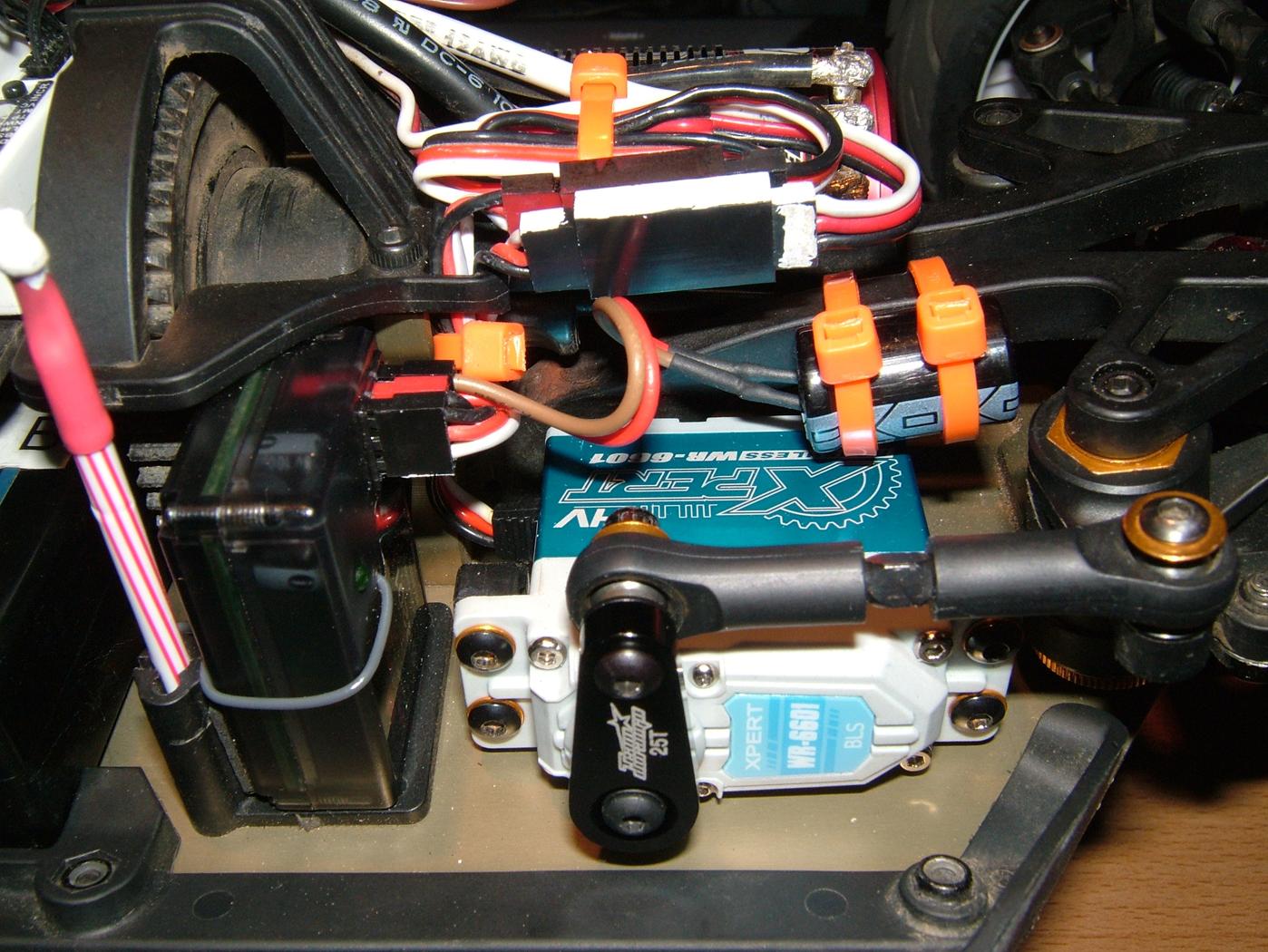

I use a few 16V 4700uF power caps in some of my RC's.
You can make those your self or buy them premade.
I know the Spektrum power cap is 16V 4700uF as well. I have an original spektrum power cap in my DEX408 V1 and I have made one my self which I have put in my FTX Viper BL.
I have a project going on, getting a Hong Nor Nexx8 ready to run and I plan to use a Mamba Monster ESC in it and I have chosen to install a Castle Creations 10A BEC as I know how weak the BEC's in the Mambas are.
However the BEC in the Tekin ESC is not weak as the BEC in the Mamba ESC's. So if you don't use HV servos with your Tekin ESC there's no need for power caps or an external BEC.
If it's to ensure that the BEC in the ESC is never drained by high draw servos this works quite well for the Tekin RX8 Gen2 ESC. After I installed a power cap in my DEX408 V1 buggy which has an Xpert RC WR-6601HV steering servo in it I can't drain the ESC anymore so the receiver shuts down due to loss in power. It would do so before I installed the power cap if I turned the wheels very rapidly from side to side as the BEC in the ESC could not keep up with the servo.
