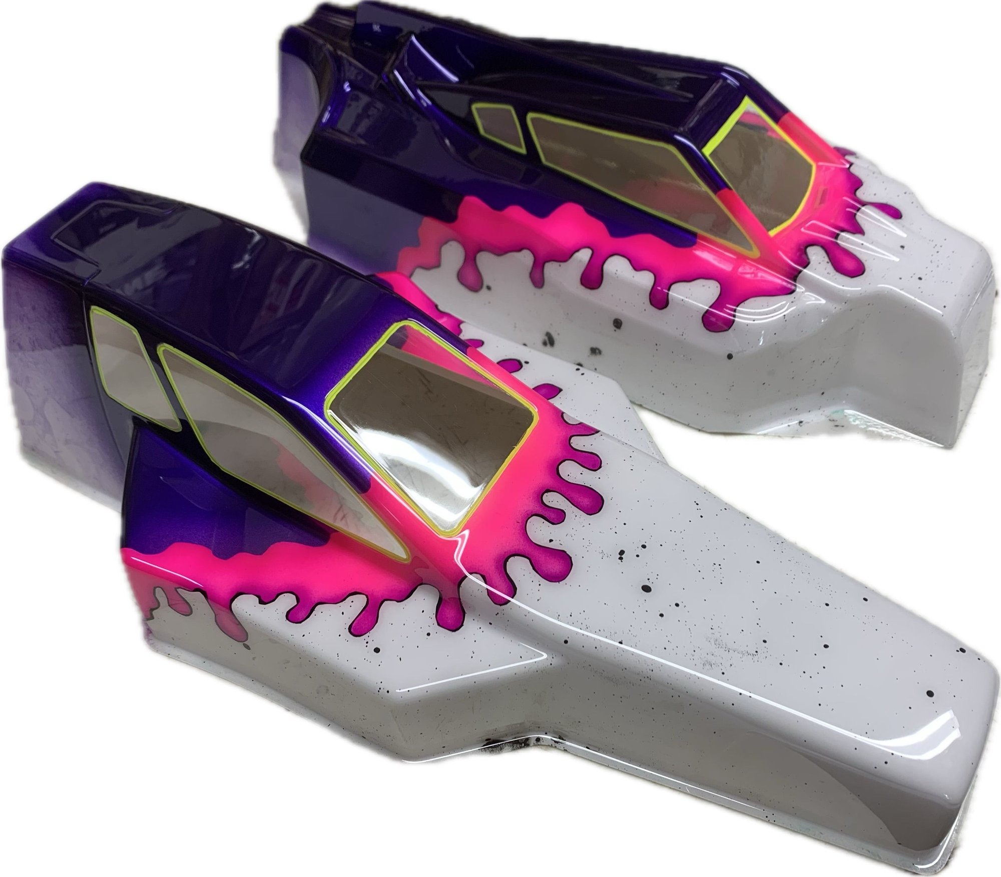

Couple for my son. Added some colors to the drips. Looks better.

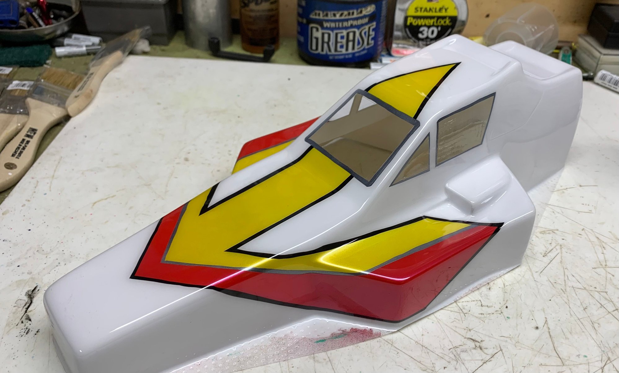

Quick one that I took some inspiration from the one Cinabun posted on page 2..Not very happy with it. Might be too much yellow or maybe I shouldn't of faded the blue into white. Doesn't help the body is hideous. I also purposely did the blue line not all the same widths and that doesn't look right either. Shaded with pearl orange under the flo orange but you can't really see it..

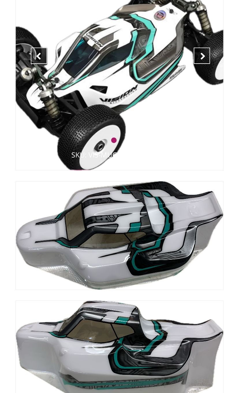

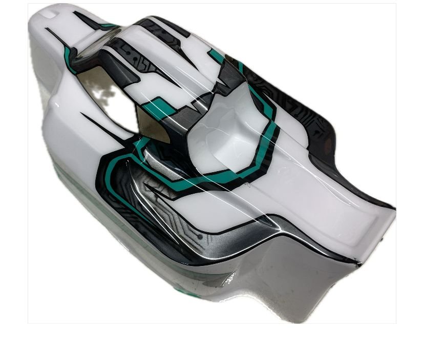

Copy of a bittydesigns body for someone at the track. He already had it drawn out and was going to attempt it for his first time using liquid mask and paint it with cans. Probably wouldn’t have worked out too good. He drew the lines thick so I just cut to both sides. Came out ok all things considered. Stencil isn’t as crisp as I’d hoped. Pulled all the silver mask at once and I shouldn’t have. Was hard to shade around some spots without getting any overspray. Thought it would be too dark wrapping the silver around the back of cab but kinda looks weird with the white there.

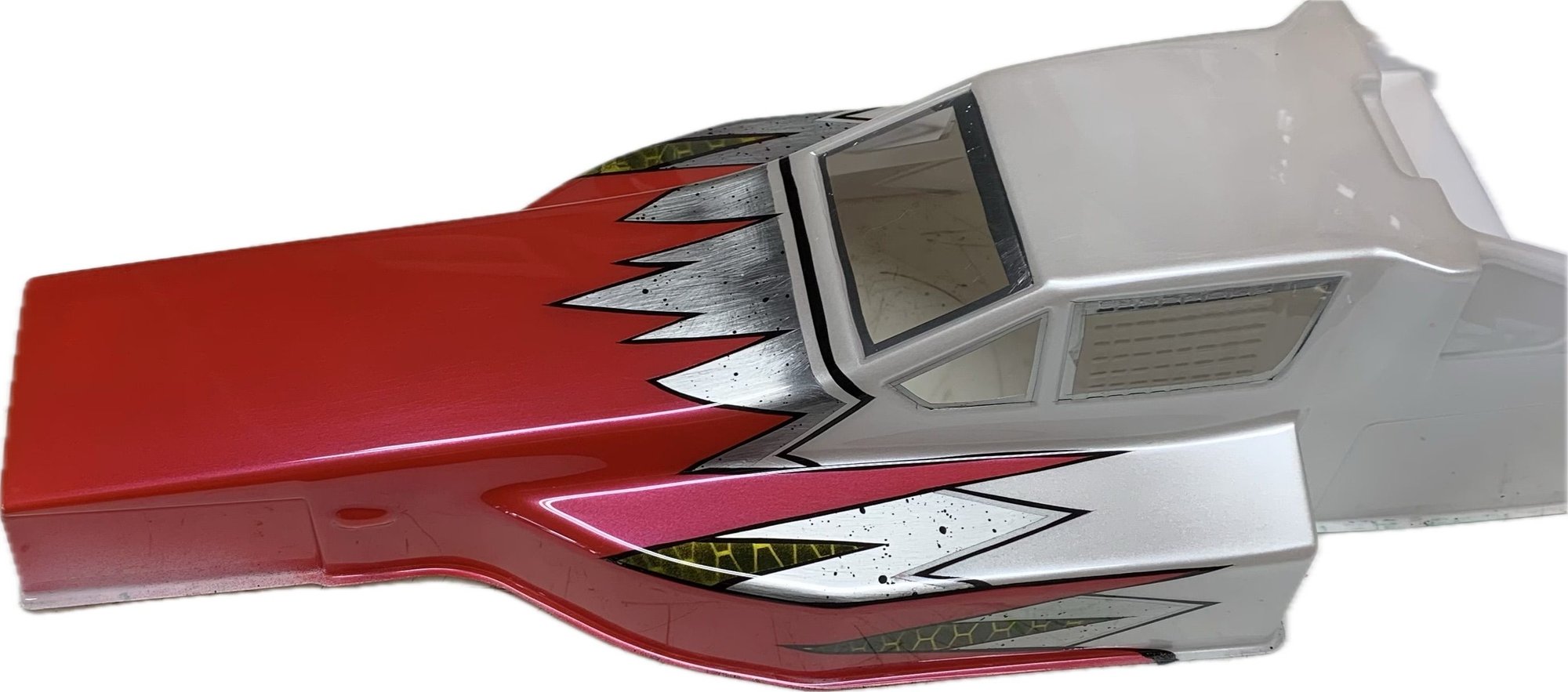

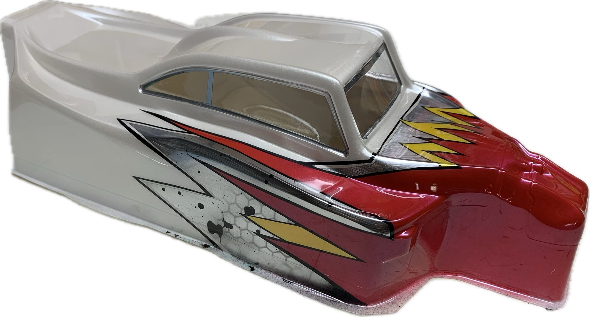

Don’t know why but this scheme is the one I struggle with the most even though it’s pretty simple. Going to switch it up next time. Ran the orange fade down too far and I overdid the pearl green shading under the Flo green. Last time you couldn’t see it so I did an extra pass. Was low on Flo green so didn’t do as many coats as normal.
