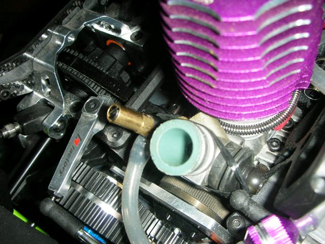

I plan on removing my servo return spring in favor for a engine return spring, what if any are you guys using for the engine? I've found a few, however, they seem geared towards big block engines.

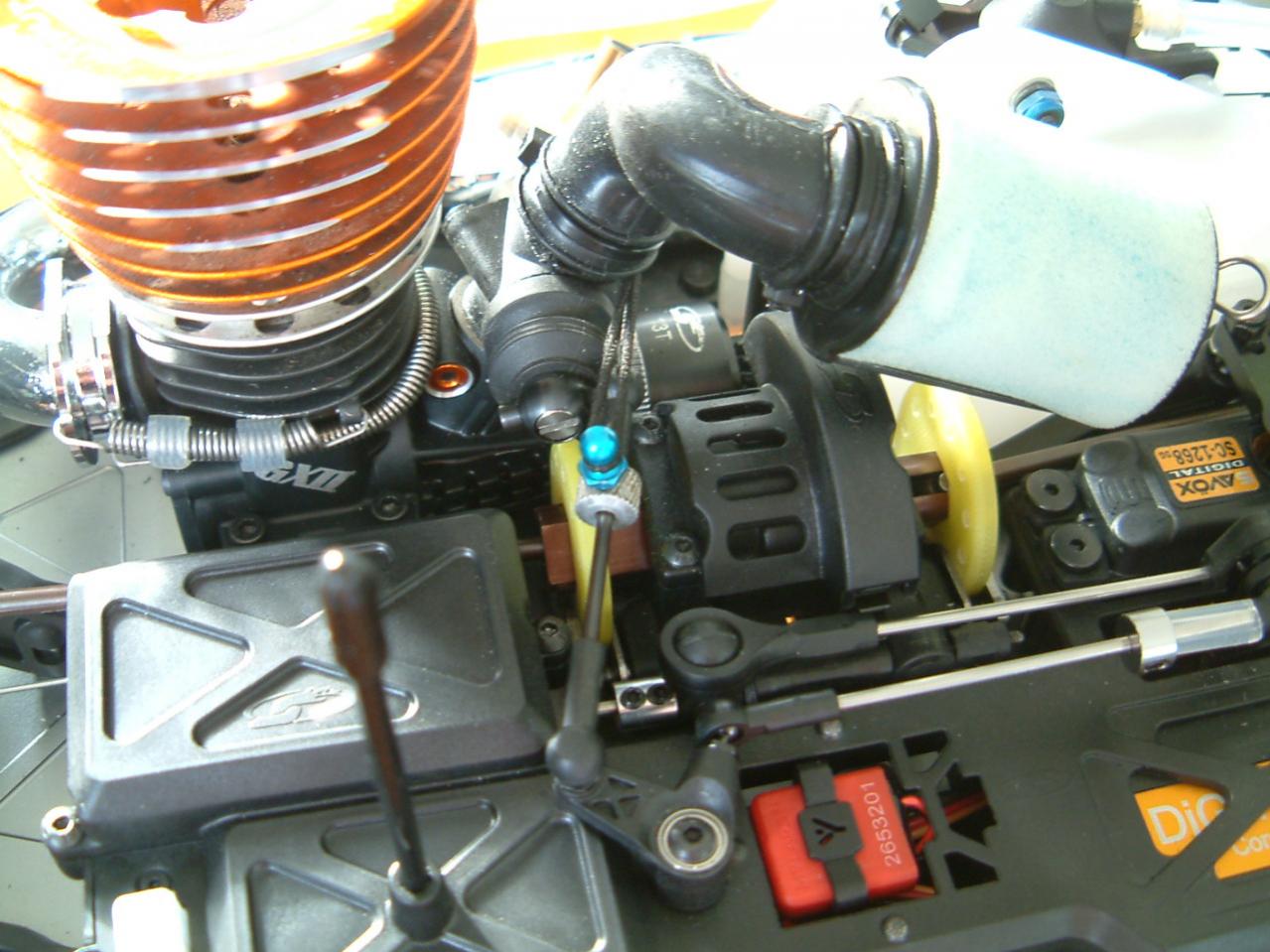

Ok, I'll pick some bands up. If I get a run-a-way, I'm sending you guys the bill..haha. I'd much rather have a metal spring on there. Do you guys have any pics of these set-ups?

Joined: May 2015
Posts: 85
JTeamtech is offline
