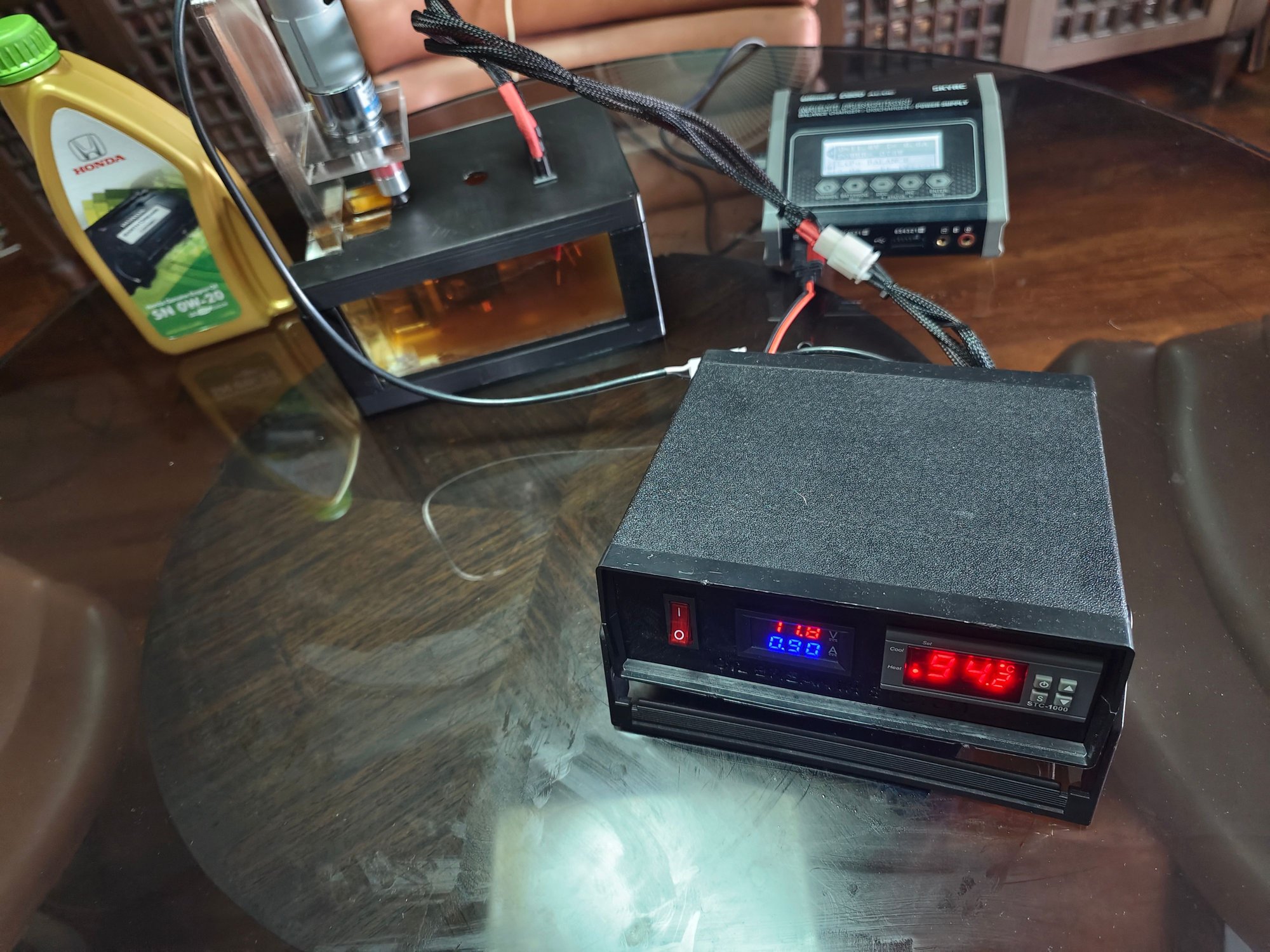

Thanks to Roelof I completed my oil break in machine. I will probably make some small minor revisions, but all in all works perfectly. When I say revision , a smaller tank so it heats up quicker. Mine takes 1.5 hours to get to 98C, once it is at temp it good to go as your only lowering it from there.
Its not the oil volume, its your heating elements/power supply. I made mine bigger than yours and in 20 minutes is at temperature. Look for better heating elements

He has the heaters just hanging in the oil. I advised to mount the heaters to a piece of heatsink to enlarge the heating surface.
I have mine just hanging in the oil too, perhaps it depends on the heaters. Or maybe a power supply with higher amperage?

I am using 2 40W heaters, and my power supply is more than enough to power them with room to spare.

It is just a combination of too much bath volume and a too small heating surface volume.
From the start I had the idea to mount the heaters on the engine. That will bring the engine directly on temperature and the volume of the engine helps to spead the heat much better.

Since I don't really have access to a machine shop I couldn't make a device that would allow me to mount my heaters to either the motor or make a full metal engine mount with the heaters mounted on it. The best I can do is find some metal heatsinks and find a way to attach the heaters to that to increase the surface area. My design is purely acrylic based with aluminum motor mounts with a 3d printed exoskeleton. It's the best I could do with what is accessable. Like I said once it warms up I am good to go from there, but it does take over an hour to reach max temp of 99c. I will try to get the heaters mounted onto a heatsink as that will still allow me to keep my current design and won't compromise my top cover.
Yes I am curious what wattage heaters your using. 20 minutes is very fast.
Mine takes just over 1 liter of oil. Around 1.3 liters to fill the box up to the top of the carb hole. System works perfectly, other than the long warm up time. If I can get that down to 30 to 45 minutes I would be satisfied.

Amazon.com: DERNORD 120V 250W Cartridge Heater Electric Hot Rod Stainless Steel Heating Element Replacement : Everything Else Amazon.com: DERNORD 120V 250W Cartridge Heater Electric Hot Rod Stainless Steel Heating Element Replacement : Everything Else
thats what I use

That explains it. I am total of 80w only and mine is completely based on 12v system. I just purchased the heatsinks so going to give that a try, if not I can increase my wattage. How many of those 250w are you running?

I'm only running 2. One each side of the motor, mounted at about the center of the sleeve bore. I don't really know the temperature at the front of the motor, as I have the 2 temp sensors punted next to the heating elements. Ive been using a 30 amp power supply
