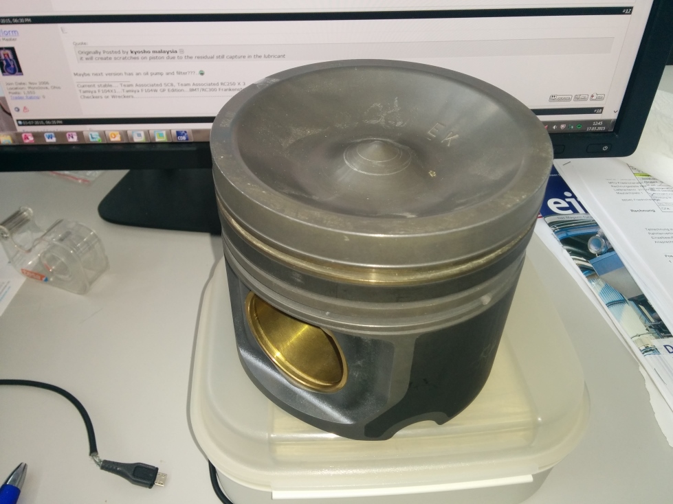

Yeah, as you have expected our Pistons are a bit larger in size than the nitro engine pistons.
I took a picture for you from one of our smaler ones...

Yeah, as you have expected our Pistons are a bit larger in size than the nitro engine pistons. I took a Picture for you from one of our smaler ones...
