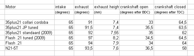

The crankshaft is (so far I know) with the tuned the main difference. Tonight I will see both engines to messure it up, then I know the real differences.
For sure with the special Flash a CNC piston is used and not the Microcasted one.

No Flash special tuned, only the older 2009 models. Between te flash and the tuned version there is not much difference in the crank timing but a huge difference with the exhaust port (the highes so far I have ever seen). Also the turbo scoop on the crankshaft was with the tuned version much larger and rounder and with the normal version quite stock.
One of te 2 was new so the guy could not tell the difference but I expect more RPM with the tuned version which may have to be lighter geared
In the attachement all engines from yesterday
