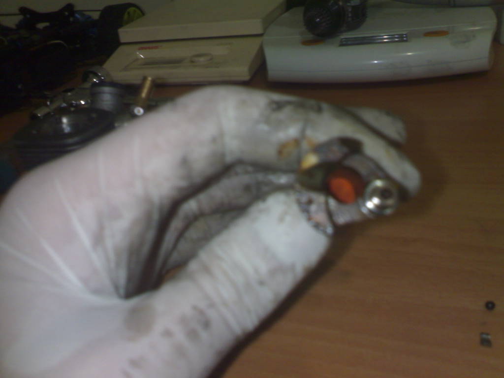

after ten months of use and about 20 litres run into it,my +3ct just died.the conrod probably broke.take in mind that i had never ever opened that engine to clean it.the only thing i did was to run some after run oil after every run....that's why i belive that novarossi are far the best and the more durable engines i've ever used between sirio, os max and nova's.i don't mean that the other brands are not good but novarossi is just one step further from every manufacturer.
i have not yet opened my engine to see what happened but i guess is the conrod.i'll post some pictures soon

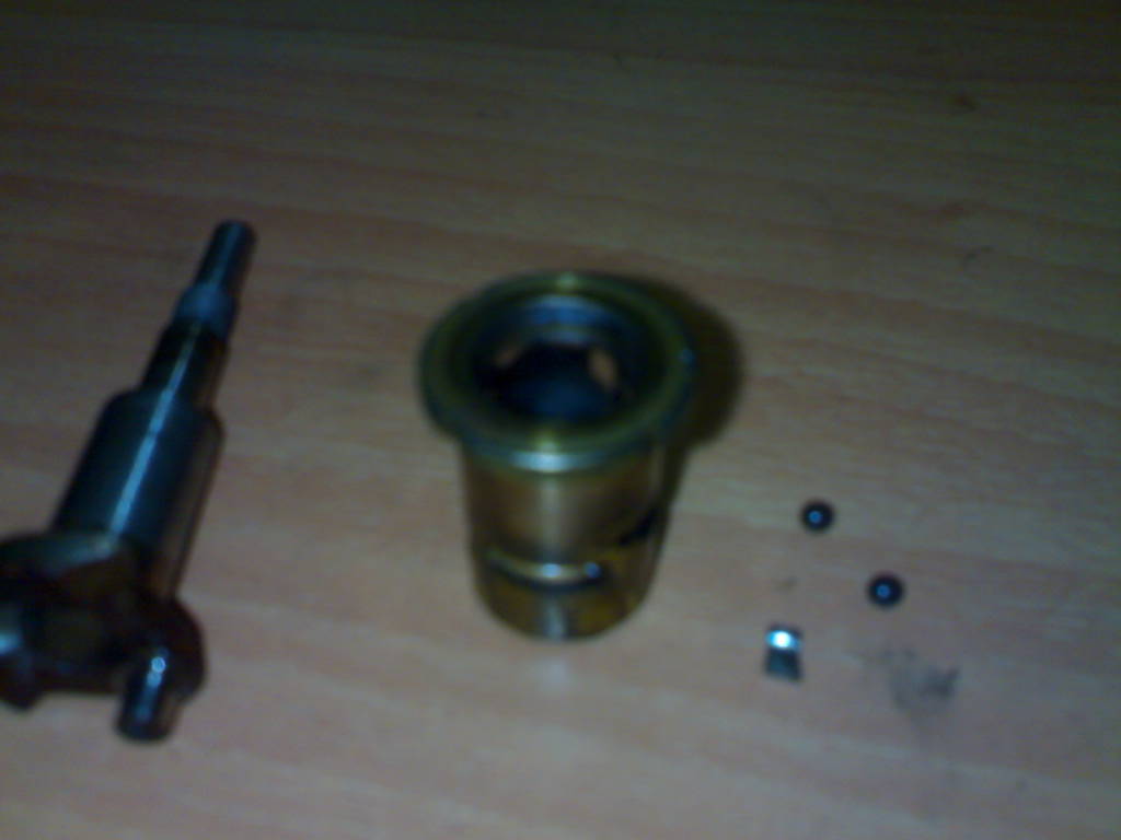

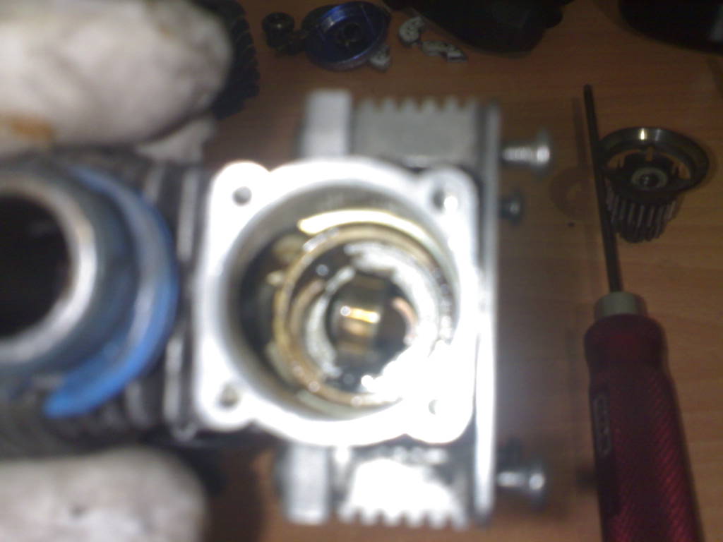

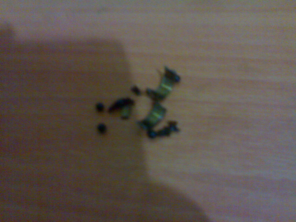

here are the pictures guys.finally it was because of the back ceramic bearing.i don't know if it's worth repairing that engine now if i take in mind that i should probably go for a piston/sleeve/conrod set as well which makes a total of about 250$ repairing cost and the cost for a new plus engine is about 310$.what do you guys think?

That's a lot of fuel ran through your engine and nothing last forever. With the high cost of rebuild, I would just get a new one. I suggest you keep the broken one for parts. You never know when you will need a cooling head, or a back plate. The carb would come in handy as well.

That engine may have still been running if you would have replaced the rear bearing after a visual check.
I agree with you that Novarossi are good engines.
Keep the parts, one day you will have enough good ones to slap a new engine back together !

i agree with you my friend.i took a close look at the bearing and there was fuel stuck between the balls!!!!the conrod and the piston were ok.the sleeve had taken some high temperatures but it still had compression.
Moreover i think i'll go for a new one and have some parts as spare...thanks a lot
