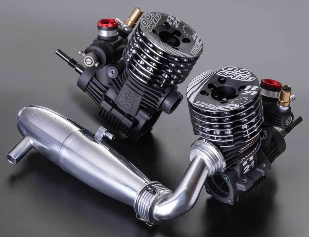

O.S.SPEED R21 EURO II
- Displacement: 3.49 cc / 0.213cu.in.
- Bore: 16.08mm / 0.633 in.
- Stroke: 17.20mm / 0.677 in.
- Output:2.8 ps / 2.76 hp / 35,000 r.p.m.
- practical rpm range: 4,000-45,000 r.p.m.
- weight:340g / 11.99 oz.
- Standard accessories
- Glow plug RP7
- Exhaust seal ring Dust cap set (φ3、φ16、φ18)

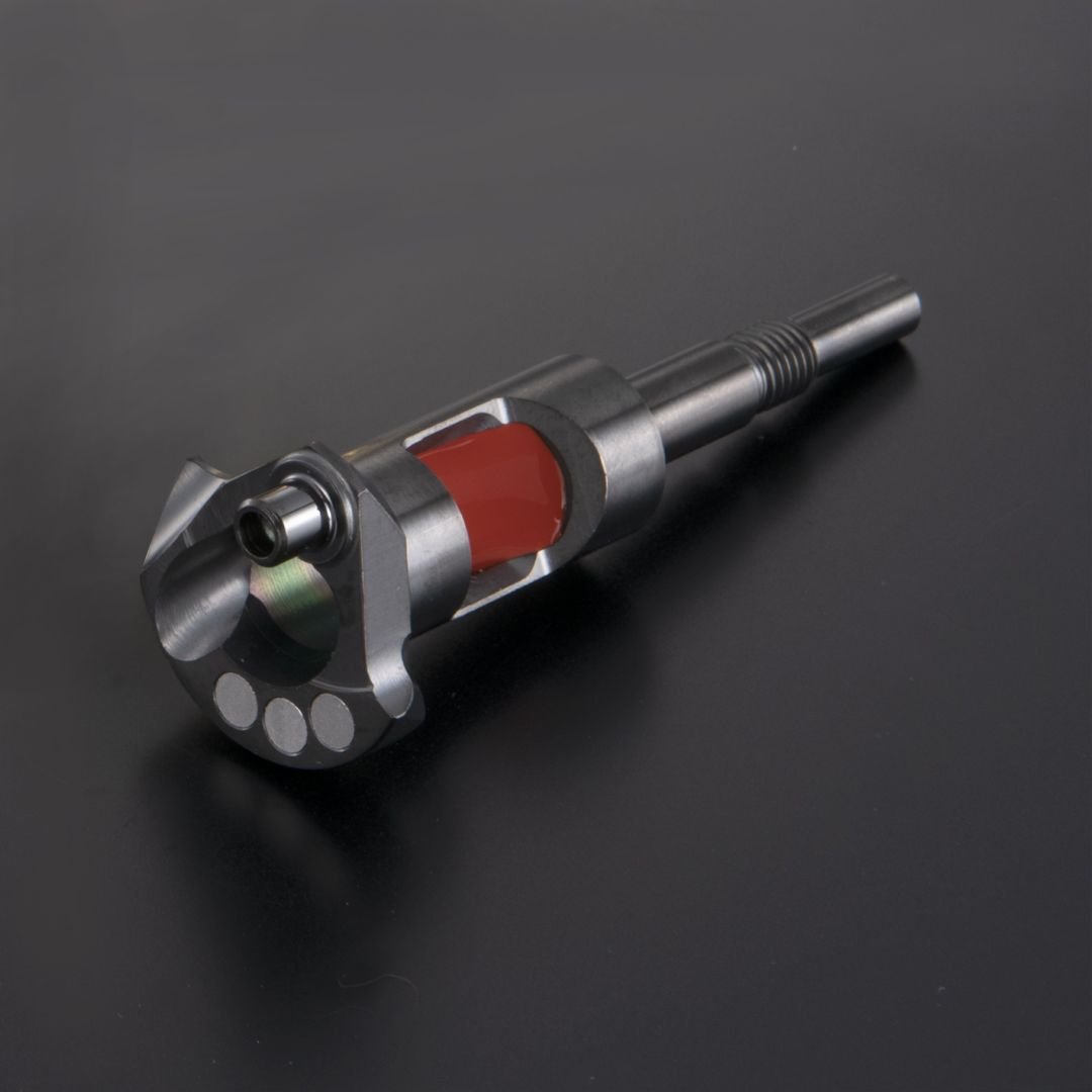

The weights are basically for balancing, maybe in the hands of a very good driver he can notice the difference, for the most there is no difference. On paper it is even a bad idea because it is more rotating mass
Just purchased a euro 2 from Rcxx the website/store is in Switzerland-I purchased the last one and it was on sale for 50%off at 268+37 dollars shipping and it all came out to 305 bucks that’s a great deal in my book any way you slice it…I’m just debating if I want to send it do Rick brake or Uriah murnan for a drag mod like I do to 90%of my engines since I run a lot of 132ft drag racing…if anyone has any experience with the euro 2 chime in and let me know what you think..I hope the break in goes smooth with no scored piston..but with it being 7 port and having the 2 lubrication holes u see the exhaust port I hope it’s easier on the piston for break in
If you can find a 2052 pipe. It's a beast on top end. It's a nova pipe though. It's a gas hog for onroad so for drag probably wouldn't bother you. I have a used spare sitting on the shelf if interested.
To keep on topic, any point in upgrading from 2103 or Euro 1 to Euro 2? If the crank weights are the only major change, I think I will just rebuild my older engines.
