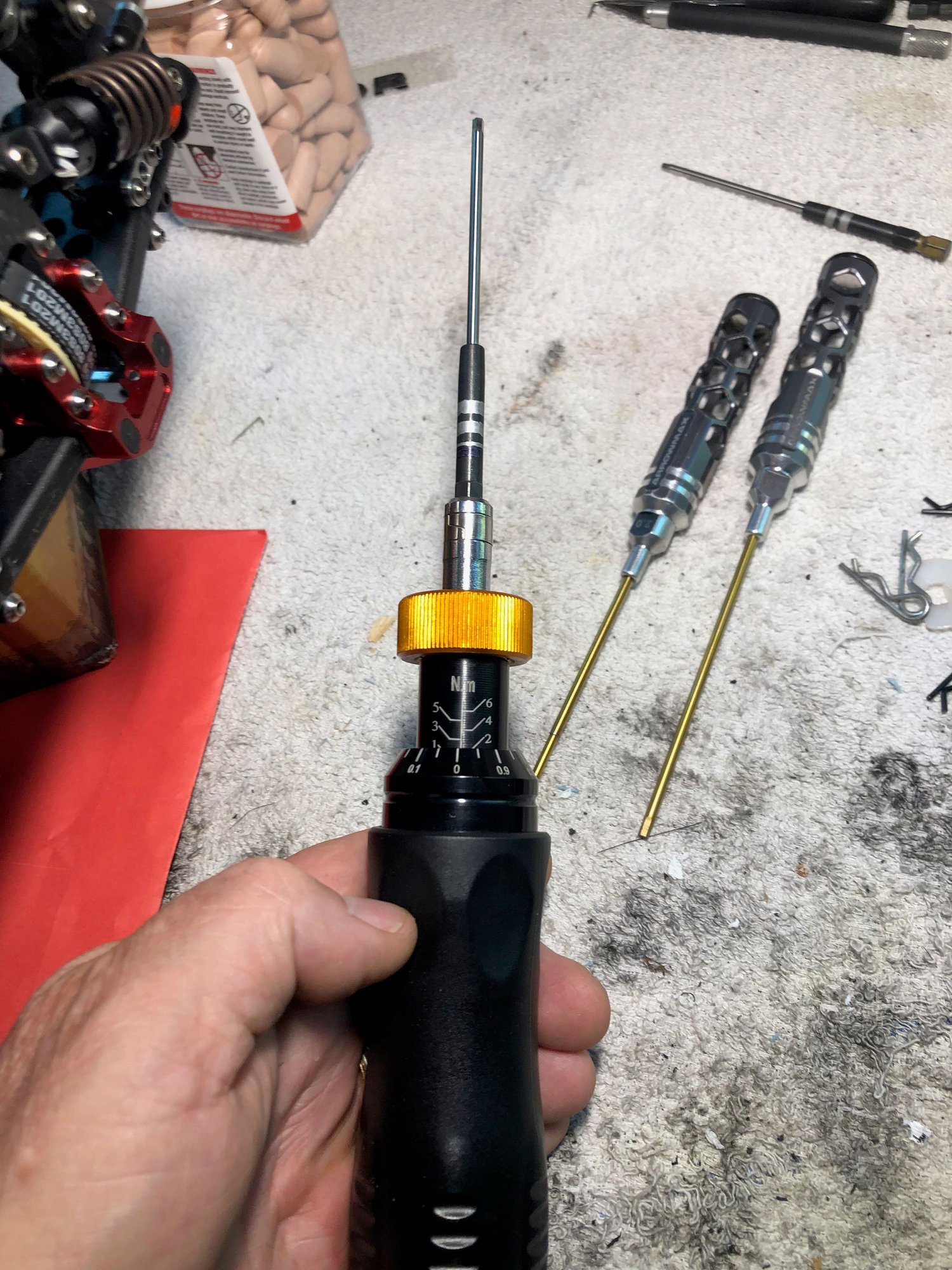

Here's mine
1/4" drive. MIP bits, straight and ball ends
